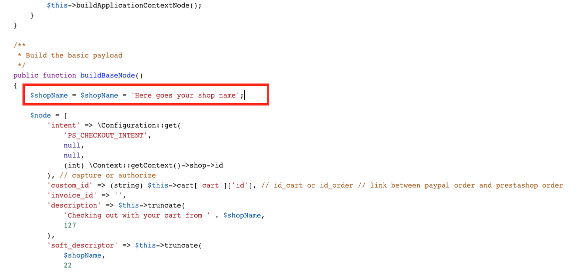

viliera Posted March 29, 2020 Author Share Posted March 29, 2020 Hello, Thank you very much for giving the solution, I really appreciate it. I hope Prestashop adds this functionality without us having to modify the code. The code: $shopName = 'Here goes your shop name'; Replace all the code: $shopName = \Configuration::get( 'PS_SHOP_NAME', null, null, (int) \Context::getContext()->shop->id ); Remaining the code like this: /** * Build the basic payload */ public function buildBaseNode() { $shopName = $shopName = 'Here goes your shop name'; $node = [ 'intent' => \Configuration::get( 'PS_CHECKOUT_INTENT', null, null, (int) \Context::getContext()->shop->id Right yes? I attached the capture to confirm if the code will be like this. Best regards Link to comment Share on other sites More sharing options...
HiPresta Modules Posted March 29, 2020 Share Posted March 29, 2020 Almost, it should be one $shopName, like this: $shopName = 'Here goes your shop name'; Also, make sure to replace 'Here goes your shop name' with the actual string you want to appear Link to comment Share on other sites More sharing options...

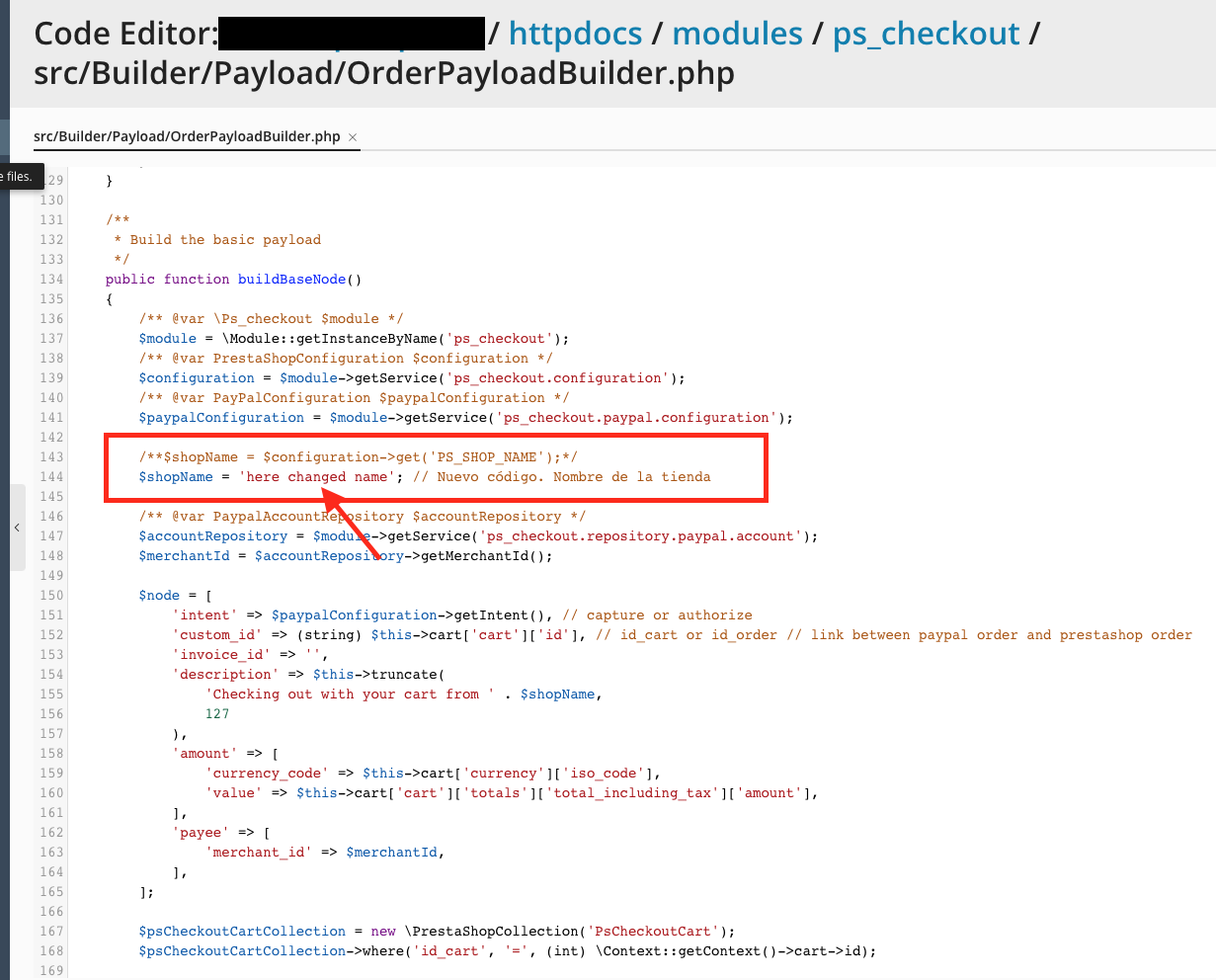

viliera Posted October 22, 2020 Author Share Posted October 22, 2020 Hi HiPresta Modules, I have updated the module ps_checkout to the latest version v2.0.5 and files from the CLASSES FOLDER disappeared. Can you help me again please? You are the only one who has helped me with this before. Where you will have put this configuration to change the name of the store again. Thank you so muchs. Best regards Link to comment Share on other sites More sharing options...
viliera Posted October 22, 2020 Author Share Posted October 22, 2020 I think I have found, now these files are in / ps_checkout / src/ The only thing that I'm not sure if I can make these changes the same as before. can you confirm? Thanks Link to comment Share on other sites More sharing options...
viliera Posted October 22, 2020 Author Share Posted October 22, 2020 Look, I have left it like that, because now it puts another code, the old code is gone. now I think it's this to change it. $shopName = $configuration->get('PS_SHOP_NAME'); Link to comment Share on other sites More sharing options...
