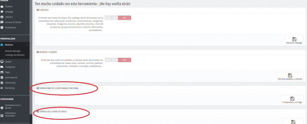

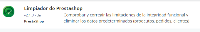

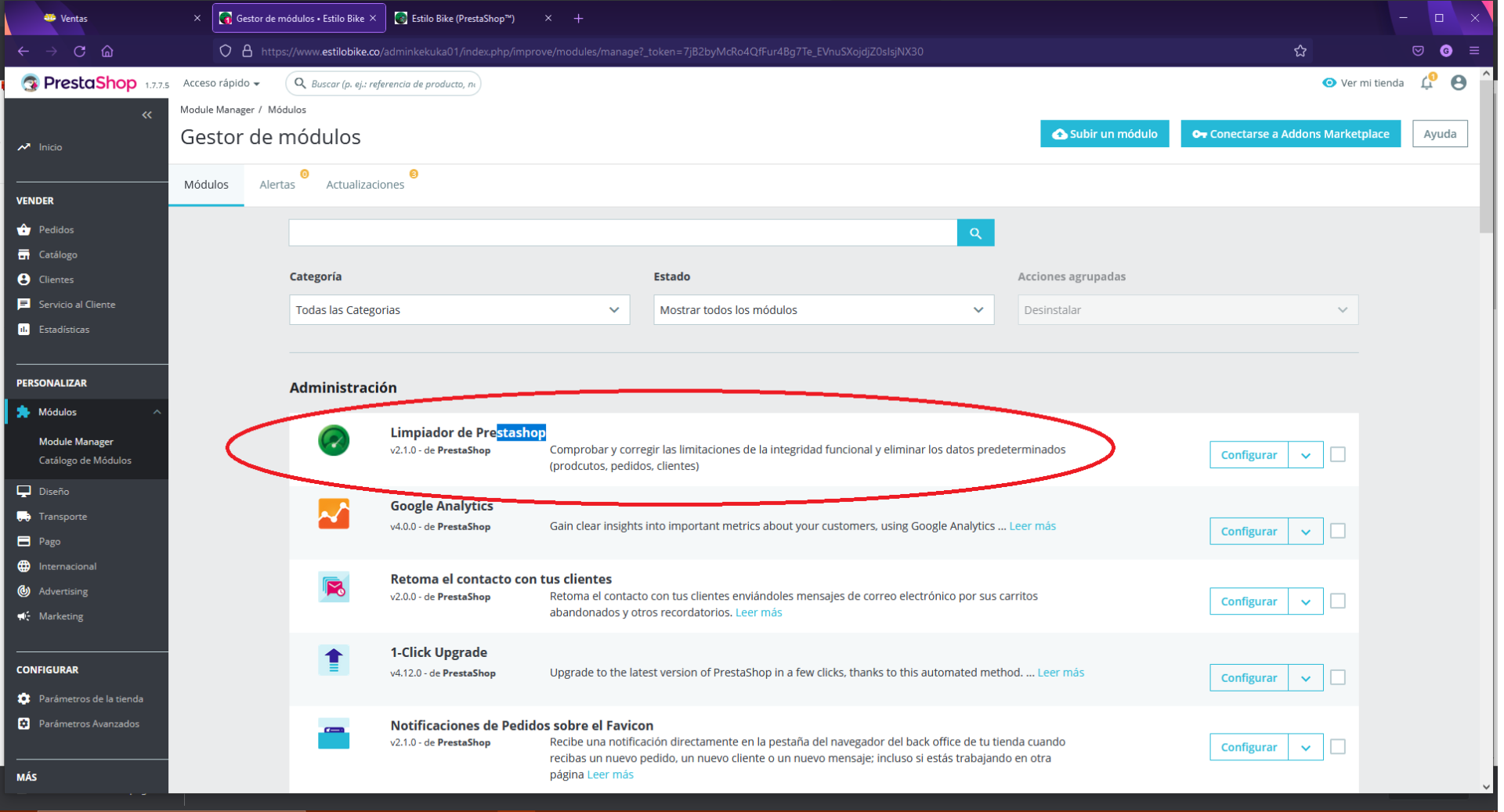

Gabriel Posted July 31, 2021 Share Posted July 31, 2021 Hola yo tenía el mismo problema, probé de todo y únicamente me funcionó correr el modulo "Limpiador de prestashop" ese soluciona problemas en la plataforma. Link to comment Share on other sites More sharing options...

Gabriel Posted August 10, 2021 Share Posted August 10, 2021 I can't find this module to download, it module was by defaul, plaese try to find with the name: cleaning to prestashop, on the administration category Link to comment Share on other sites More sharing options...
Biscotto Posted August 10, 2021 Share Posted August 10, 2021 12 hours ago, Gabriel said: I can't find this module to download, it module was by defaul, plaese try to find with the name: cleaning to prestashop, on the administration category I did a search, and this seems to be a module that is no longer maintained. only an old version is available on Github, which I don't even think is compatible with Prestashop 1.7.x. Anyway, it seems to be a module to delete products or databases. How did you use it to correct the problem? Link to comment Share on other sites More sharing options...

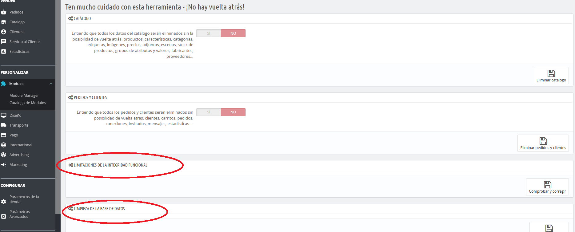

Gabriel Posted August 11, 2021 Share Posted August 11, 2021 hello you have only run the "functional integrity" or "data base" I sent the file to install pscleaner (1).zip pscleaner.zip Link to comment Share on other sites More sharing options...
Biscotto Posted August 11, 2021 Share Posted August 11, 2021 Thanks for your help! I managed to download the module and install it. I have done the steps you mentioned, but when I go to upgrade I have the same problems.😔 Link to comment Share on other sites More sharing options...
