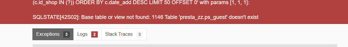

see_k Posted January 29, 2020 Author Share Posted January 29, 2020 sorry nachtrag 1.7.6.2 PHP 7.2 (7.3) Debug modus (dafür gibt es ihn ja) An exception occurred while executing 'SELECT c.id_customer, c.firstname, c.lastname, c.email, c.active, c.newsletter, c.optin, c.date_add, gl.name as social_title, s.name as shop_name, c.company, (SELECT SUM(total_paid_real / conversion_rate) FROM ps_orders o WHERE (o.id_customer = c.id_customer) AND (o.id_shop IN (?)) AND (o.valid = 1)) as total_spent, (SELECT c.date_add FROM ps_guest g LEFT JOIN ps_connections con ON con.id_guest = g.id_guest WHERE g.id_customer = c.id_customer ORDER BY c.date_add DESC LIMIT 1) as connect FROM ps_customer c LEFT JOIN ps_gender_lang gl ON c.id_gender = gl.id_gender AND gl.id_lang = ? LEFT JOIN ps_shop s ON c.id_shop = s.id_shop WHERE (c.deleted = 0) AND (c.id_shop IN (?)) ORDER BY c.date_add DESC LIMIT 50 OFFSET 0' with params [1, 1, 1]: SQLSTATE[42S02]: Base table or view not found: 1146 Table 'presta_zz.ps_guest' doesn't exist Link to comment Share on other sites More sharing options...
see_k Posted January 29, 2020 Author Share Posted January 29, 2020 Hier noch ein Link (ist testumfeld) https://www.art-outdoor.ch/shop_61/admin427mkcmkl/index.php/sell/customers/?_token=aB-ILc1Oyhc4f_SrIXC5xUOcwD2Zsshf_Om22lOcGT4 Jetzt sehe ich nur Bahnhof ... Link to comment Share on other sites More sharing options...

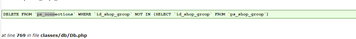

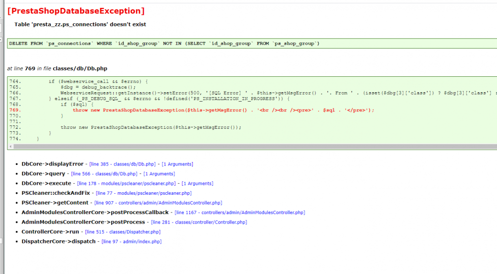

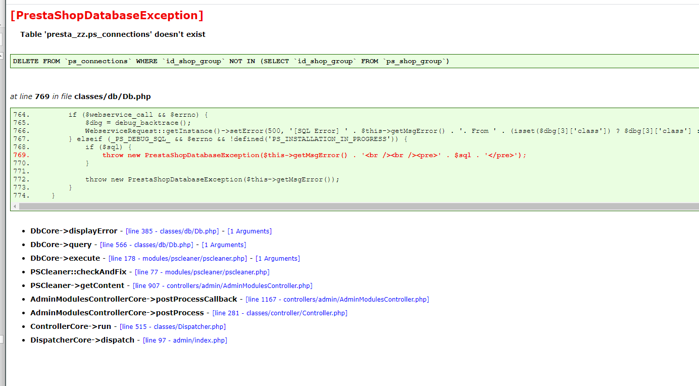

see_k Posted January 29, 2020 Author Share Posted January 29, 2020 hier noch mehr Fehler Link to comment Share on other sites More sharing options...

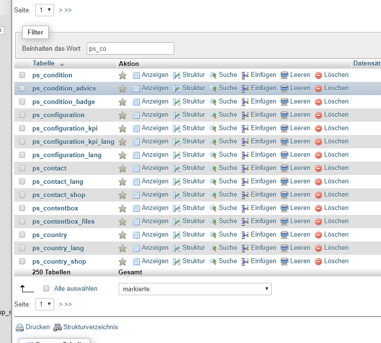

see_k Posted January 29, 2020 Author Share Posted January 29, 2020 Habe was gelesen das es die ps_connections braucht die habe ich nicht Ich habe hier = Ahnung was ich mache ... Link to comment Share on other sites More sharing options...
Wuschel Posted January 29, 2020 Share Posted January 29, 2020 3 minutes ago, see_k said: Habe was gelesen das es die ps_connections braucht die habe ich nicht Da deutet wohl einiges darauf hin, dass deine Datenbank nicht vollständig ist und eine Reihe von Tabellen fehlen. So wird das nichts. Link to comment Share on other sites More sharing options...

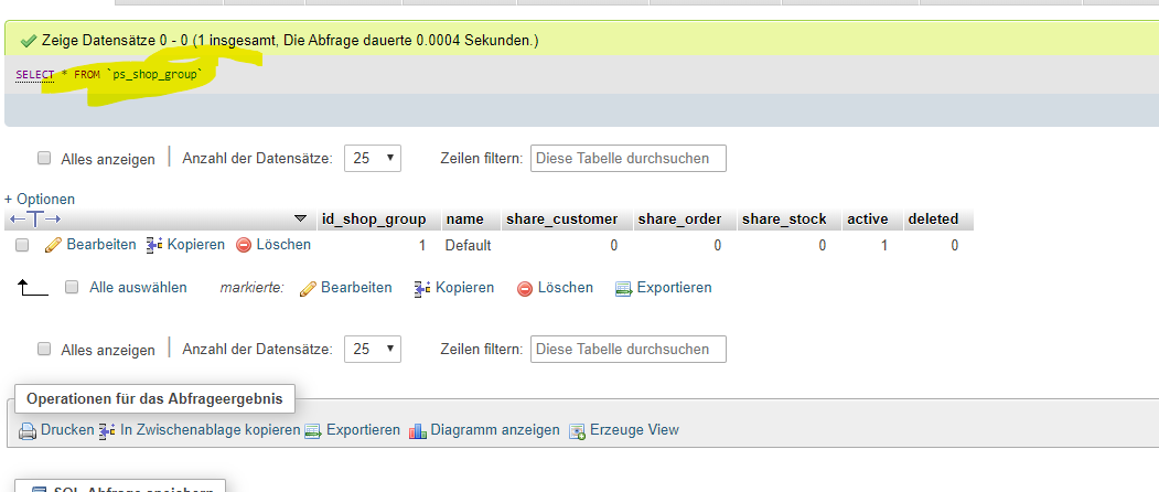

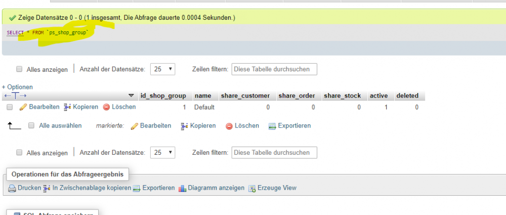

see_k Posted January 29, 2020 Author Share Posted January 29, 2020 Hier fehlt was Habe das gefunden Please check table in your database with name ps_shop_group. Default cloumns of this table are 1) id_shop_group 2) name 3) share_customer 4) share_order 5) share_stock 6) active 7) deleted If there is haven't any table with this name then you need to run this sql query in your database CREATE TABLE IF NOT EXISTS `ps_shop_group` ( `id_shop_group` int(11) unsigned NOT NULL AUTO_INCREMENT, `name` varchar(64) NOT NULL, `share_customer` tinyint(1) NOT NULL, `share_order` tinyint(1) NOT NULL, `share_stock` tinyint(1) NOT NULL, `active` tinyint(1) NOT NULL DEFAULT '1', `deleted` tinyint(1) NOT NULL DEFAULT '0', PRIMARY KEY (`id_shop_group`) ) ENGINE=InnoDB DEFAULT CHARSET=utf8 AUTO_INCREMENT=2 ; INSERT INTO `ps_shop_group` (`id_shop_group`, `name`, `share_customer`, `share_order`, `share_stock`, `active`, `deleted`) VALUES (1, 'Default', 0, 0, 0, 1, 0); Link to comment Share on other sites More sharing options...
see_k Posted January 29, 2020 Author Share Posted January 29, 2020 sorry vielleicht ist da dir richtige spur ps_guest does not exist Link to comment Share on other sites More sharing options...
