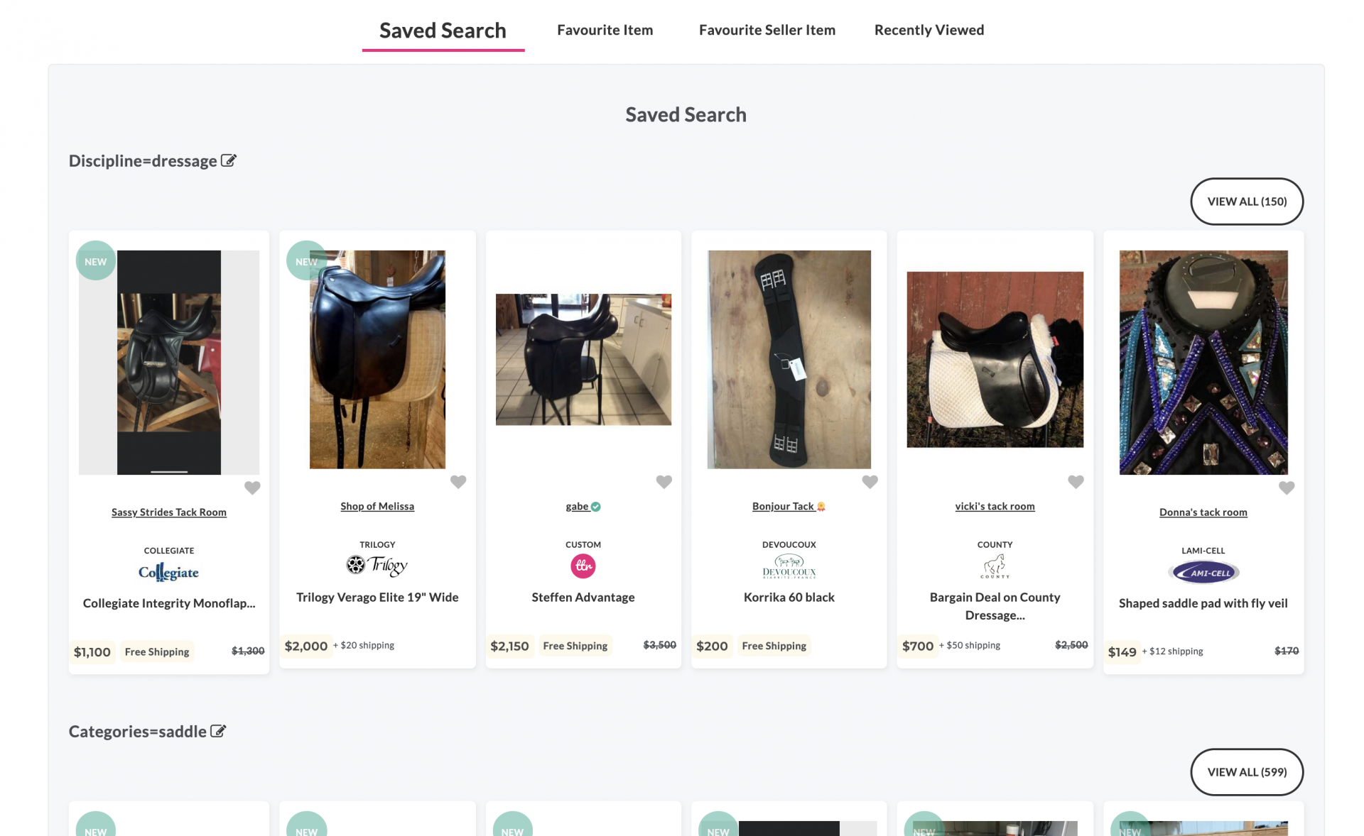

First of all I have added the PHP file which was not loading in the override of the front controller :
include_once(_PS_MODULE_DIR_ .'advansedwishlist/controllers/front/mywishlist.php');
in public function install() of the module I have added
            $this->registerHook('displayNav')  &&
            $this->registerHook('displayHome')  &&
            $this->registerHook('displayHomeTabContent');
and
        public function hookdisplayHome()
          $data_template = $this->wishlistBildShortContent();
            $this->context->smarty->assign($data_template);
         return $this->display(__FILE__, 'mywishlist.tpl');
    public function hookdisplayHomeTabContent($params)
//         {$link->getModuleLink('advansedwishlist', 'mywishlist', array(), true)|addslashes}
             console_LOG($data_template);
I was not sure what was the correct hook, so I added the module to the 2 hooks where modules on the homepage are displayed.
The module is showing but all datas from the front controller module are not processed and no datas are showing.
Thanks!
