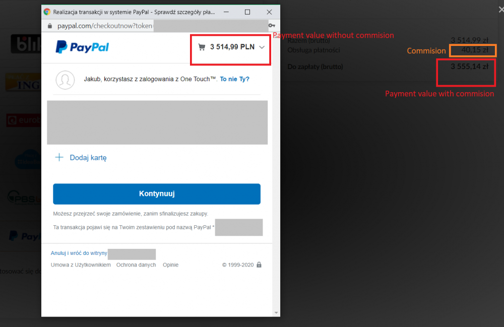

polish Posted January 16, 2020 Share Posted January 16, 2020 Hello, Module: https://www.bvkyazilim.com/cart/pricing-discounts/prestashop-additional-payment-fees.html It says it is compatible with PayPal. In my shop it does'nt work. The customer sees the commission in the checkout, but after switching to Paypal he sees the amount without commission. I've checked several PayPal and APF module settings combinations but it just doesn't work with PayPal properly. I've also written to the author but no answear since Monday. PS. 1.7.6.1. PayPal official module v5.1.0. Where to look? What to check? Did you have problem contacting this author? Thanks! Jakub Link to comment Share on other sites More sharing options...

polish Posted January 16, 2020 Author Share Posted January 16, 2020 Yes that's right. The fee charged is lower than the PayPal commission and it is not applied to PayPal only, so it meets these conditions. The question is why this module does not transfer commissions to Paypal. Does it require any additional arrangements with PayPal or should I look for a problem in this module? Link to comment Share on other sites More sharing options...
selectshop.at Posted January 16, 2020 Share Posted January 16, 2020 On 1/16/2020 at 12:25 PM, polish said: The question is why this module does not transfer commissions to Paypal. Expand Because it is not allowed.... Do yo have their written consent ? On 1/16/2020 at 12:07 PM, selectshop.at said: No Surcharges. You agree that you will not impose a surcharge or any other fee for accepting PayPal as a payment method without our prior written consent. Expand Calculate surcharges into your products prices and make the opposite. Give a discount to other payment methods. So Paypal cannot see what you are doing. As extra designated fee line paypal will refuse/ignore it when transmitted to paypal. Link to comment Share on other sites More sharing options...
