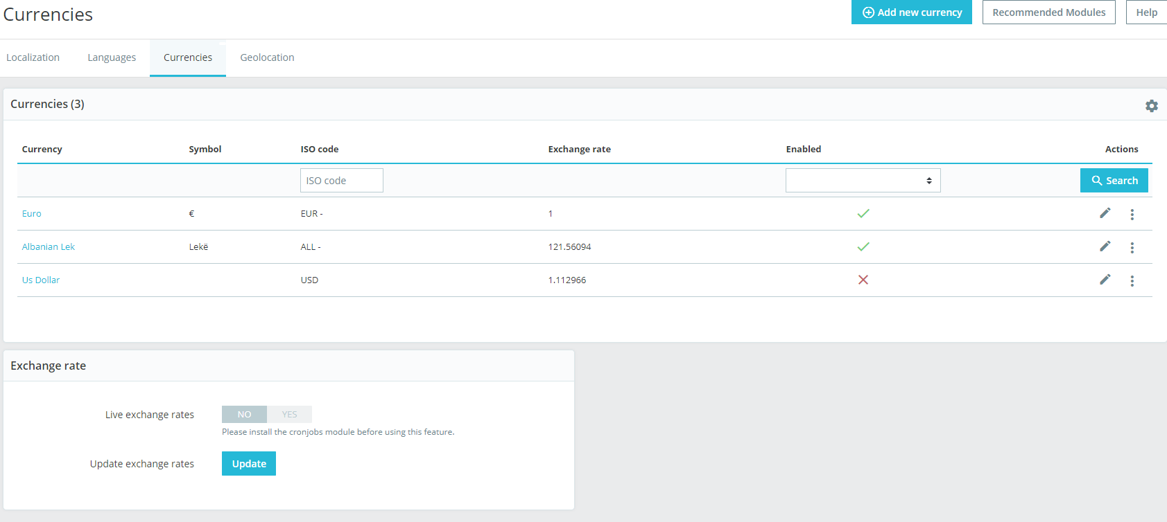

Iris96 Posted January 15, 2020 Share Posted January 15, 2020 (edited) Hello everyone, I am interesting to do an auto-update of exchange rate in my shop. Here is where I do the Update of exchange rate manually, at the UPDATE button. Can you tell me how can I do it ? Maybe it is possible with cronjob, but how can I write the script that does the update ? Thank you in advance! Edited March 5, 2020 by Iris96 (see edit history) Link to comment Share on other sites More sharing options...
