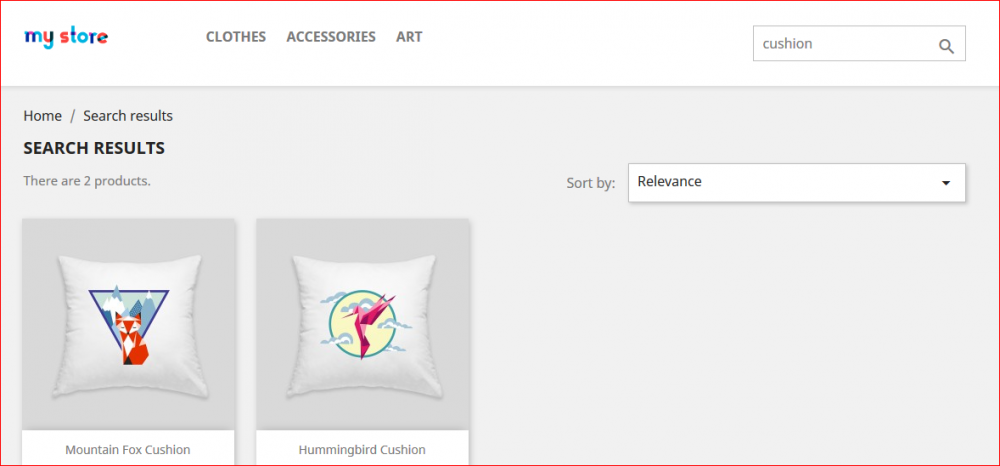

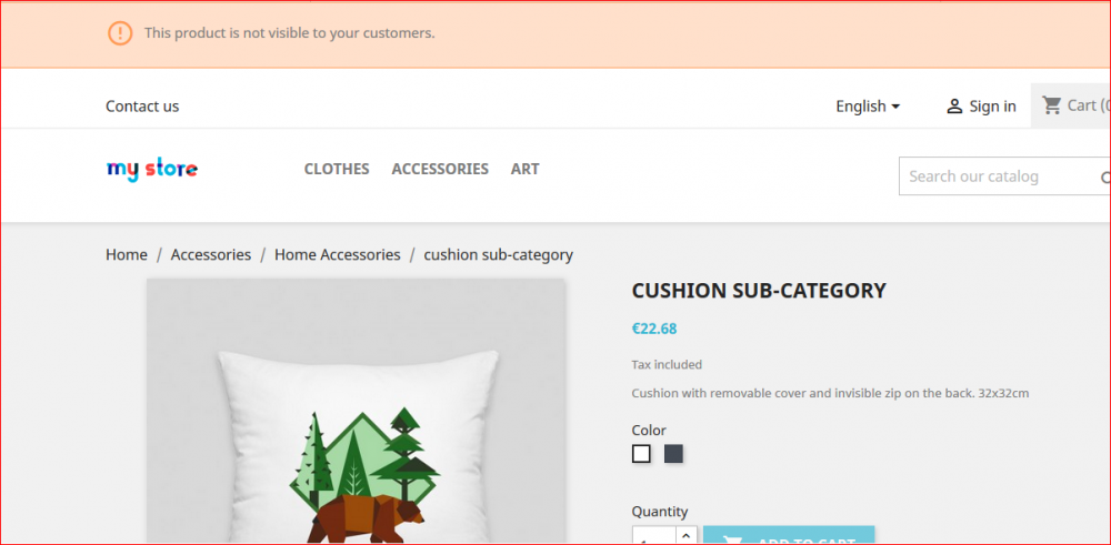

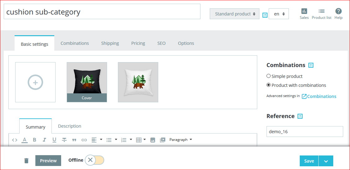

selectshop.at Posted January 16, 2020 Share Posted January 16, 2020 6 hours ago, stevencage said: ruby81.ml If you have enabled the module featured products, then it has applied what you did. I cannot see any product on main site. The purpose to link the products to "root" is for to have them linked to the module "featured products". Pay attention that one category must be a main category ! You cannot link products only to sub-categories. If you add a product only to a sub-category it will be not shown everywhere ! Just made a test on fresh installed 1.7.6. Added the product "cushion sub-ctegory" only to a sub-category: It is not visible as you can see: It is also not searchable: Perhaps you are using on your PS 1.6. an adapted non-native theme working by this way, but it's not Prestashop native code. If your problem is with filter (facetted search, or what?) If yes you should reset it and re add all filters. Link to comment Share on other sites More sharing options...

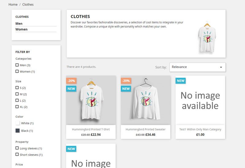

stevencage Posted January 16, 2020 Author Share Posted January 16, 2020 (edited) no, the problem is nothing about feature products module, it's the product that has only one category selected showing on the other category. like below for example, I only want test1 shows only on the Men category not the Clothes category. In fact, the CLOTHES category should have nothing as every products shows here are under MEN and WOMEN category, I don't know if this is how the PS should work this way or it's a bug. Edited January 16, 2020 by stevencage (see edit history) Link to comment Share on other sites More sharing options...

Daresh Posted January 23, 2020 Share Posted January 23, 2020 The products from subcategories show probably because of the faceted search module, you can configure it not to shop products from subcategories. 1 2 Link to comment Share on other sites More sharing options...
stevencage Posted January 24, 2020 Author Share Posted January 24, 2020 19 hours ago, Daresh said: The products from subcategories show probably because of the faceted search module, you can configure it not to shop products from subcategories. you are the man! problem solved. that's so simple without even coding. Thank you so much. Link to comment Share on other sites More sharing options...
