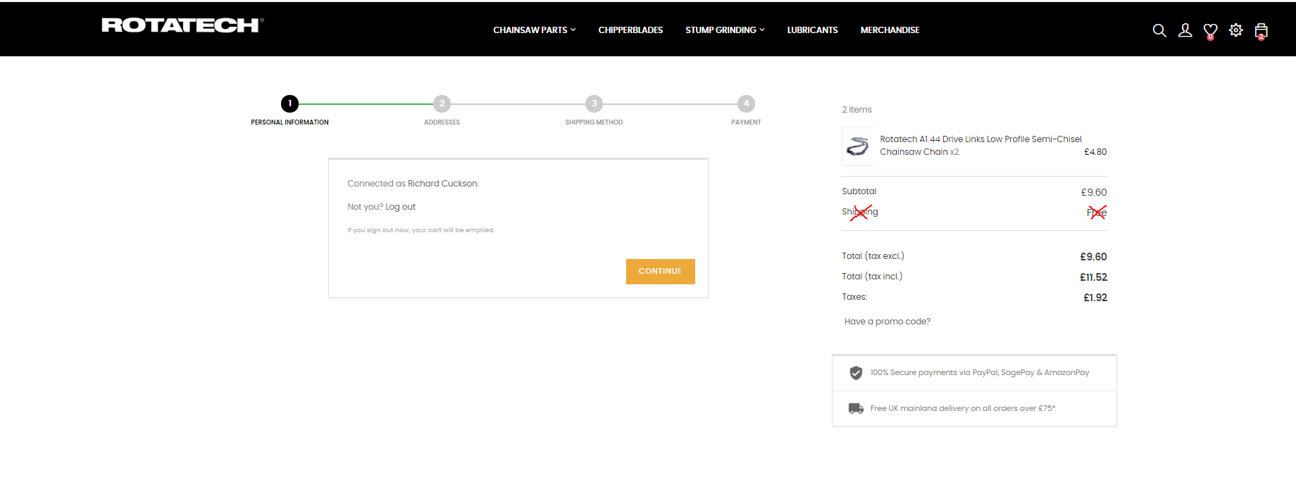

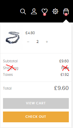

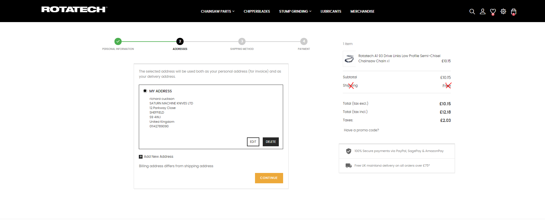

I have attached some images of exactly what i mean.

Code 1. = image 2
Code 2. =  image 1
image 3 and image 4, There is no standard 5 step order in Prestashop 1.7, so you can't advise.
If you put the codes where I wrote, you would see a change.
But you can add another condition to code 2. for which pages the code will be valid.
{if $subtotal.type === 'shipping' && $page.name === 'cart'}style="display:none;"{/if}
Edited by Guest (see edit history)
