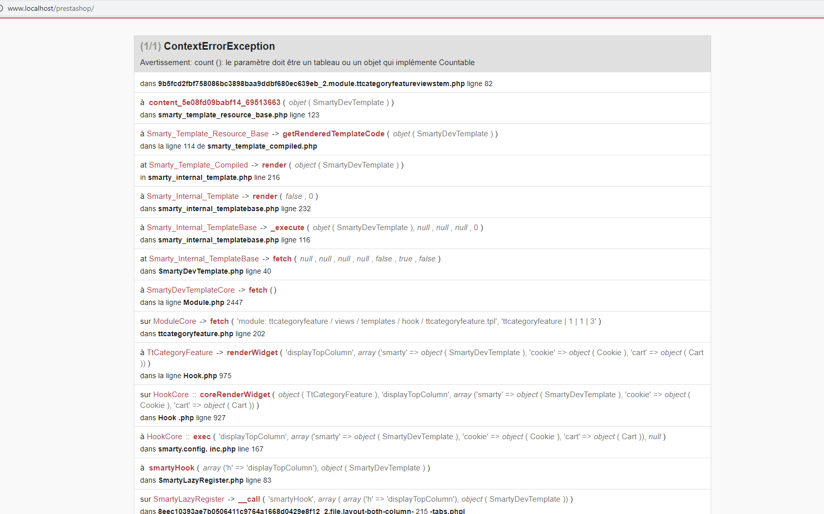

prudenziani Posted December 29, 2019 Share Posted December 29, 2019 B suite a mon problème de catégorie j'ai essayer de trouver une solution mais j'ai fait pire impossible d'aller dans ma black office sans activer la console debug Link to comment Share on other sites More sharing options...
Eolia Posted December 29, 2019 Share Posted December 29, 2019 un module (ttcategoryfeatureviewsytem) qui n'est pas compatible PHP 7.2^^ Link to comment Share on other sites More sharing options...
prudenziani Posted December 29, 2019 Author Share Posted December 29, 2019 Pourtant il est installé de puis 1 jour sans problème que puis-je faire pour résoudre le problème ? et merci de votre rapidité Link to comment Share on other sites More sharing options...
Eolia Posted December 29, 2019 Share Posted December 29, 2019 Preuve que non, vos problèmes sont justement apparus depuis qu'il est installé supprimez ce module de votre ftp. Link to comment Share on other sites More sharing options...
prudenziani Posted December 29, 2019 Author Share Posted December 29, 2019 je viens de le supprimé mais le problème persiste si je impossible d'aller dans mon black office sans mettre la commande debug Link to comment Share on other sites More sharing options...
prudenziani Posted December 29, 2019 Author Share Posted December 29, 2019 j'ai nettoyer mon historique et mon cache internet relancer wamp server Link to comment Share on other sites More sharing options...
Eolia Posted December 29, 2019 Share Posted December 29, 2019 il faut vider le cache dans /app/cache aussi Link to comment Share on other sites More sharing options...
prudenziani Posted December 29, 2019 Author Share Posted December 29, 2019 comment faire ? Link to comment Share on other sites More sharing options...
prudenziani Posted December 29, 2019 Author Share Posted December 29, 2019 j'ai trouver je vais essayer maintenant Link to comment Share on other sites More sharing options...
prudenziani Posted December 29, 2019 Author Share Posted December 29, 2019 j'ai plus aucun erreur mais malgré le vide cache le redémarrage de mon pc rien n'y fait je vais recommencer a 0 car j'ai installer la même chose sur un serveur test et j'ai aucun erreur alors que j'ai le fichier installer qui pose problème sur le serveur test bizarre quand même je ne sais pas ce que j'ai pu faire pour causé tout ca Link to comment Share on other sites More sharing options...
