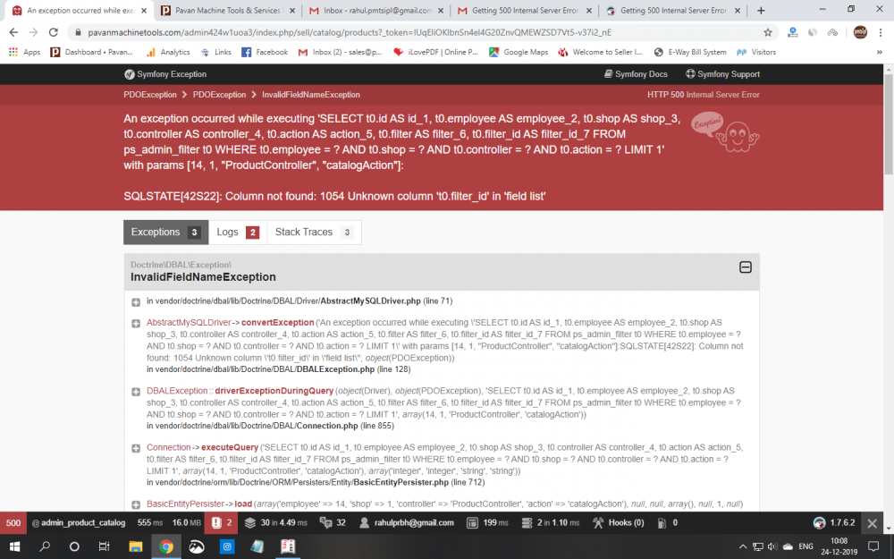

Rahulprbh Posted December 24, 2019 Author Share Posted December 24, 2019 Hello i activated the debug mode i'm getting the following error And this happened after updating to latest prestashop version Link to comment Share on other sites More sharing options...
selectshop.at Posted December 24, 2019 Share Posted December 24, 2019 1) Access your FTP and delete all folders and files in var/cache. 2) If this does not solve the problem, then access database via phpmyadmin and execute the following query: ALTER TABLE `ps_admin_filter` ADD `filter_id` INT NOT NULL ; 3) If this query also does not work for you and you are getting some more errors with same thing (for ex: Unknown column 'id_contact' in 'order clause', then run the complete query, to add all possible missing things: ALTER TABLE `PREFIX_admin_filter` ADD `filter_id` VARCHAR (255) DEFAULT '' NOT NULL AFTER `shop`, DROP INDEX IF EXISTS `admin_filter_search_idx`, DROP INDEX IF EXISTS `search_idx`, ADD UNIQUE INDEX `admin_filter_search_id_idx` (`employee`, `shop`, `controller`, `action`, `filter_id`) ;``` Theses 3 fixes should solve your problem and extend your database on missing things. 1 Link to comment Share on other sites More sharing options...

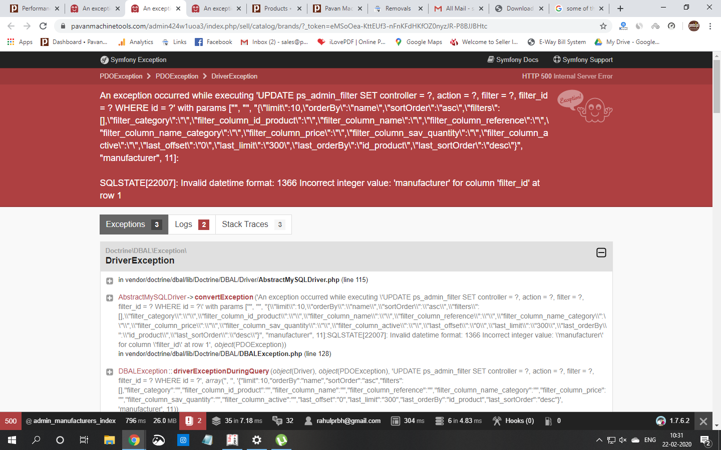

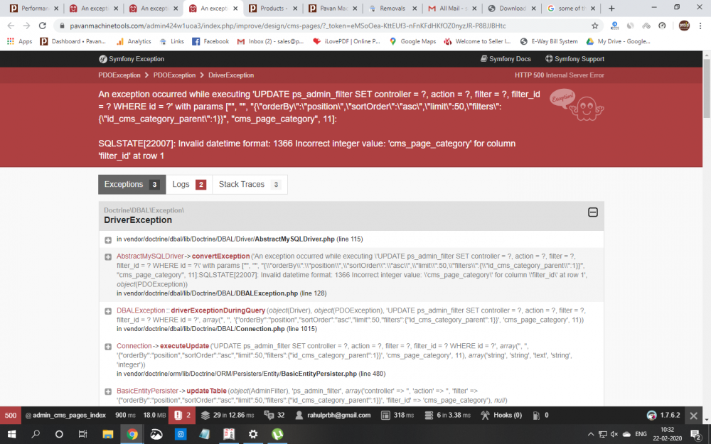

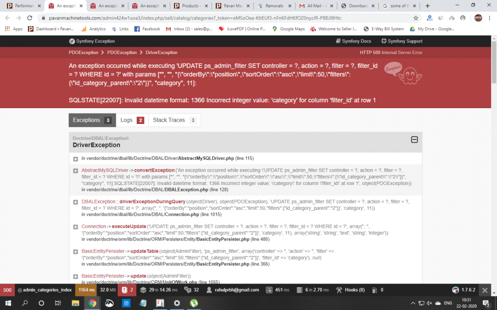

Rahulprbh Posted February 22, 2020 Author Share Posted February 22, 2020 Hello Thanks It worked for products page. But still i'm not able access some of the pages categories,brands,pages etc below i'm attaching some screenshots if you know the solution please let me know. Thank You Link to comment Share on other sites More sharing options...

JBW Posted February 25, 2020 Share Posted February 25, 2020 Ok, you wrote PHP 7.3.6. in the initial post. Try the following: 1. Make a DB Backup 2. Download and store the DB backp locally 2. Delete all entries from table ps_admin_filter Link to comment Share on other sites More sharing options...

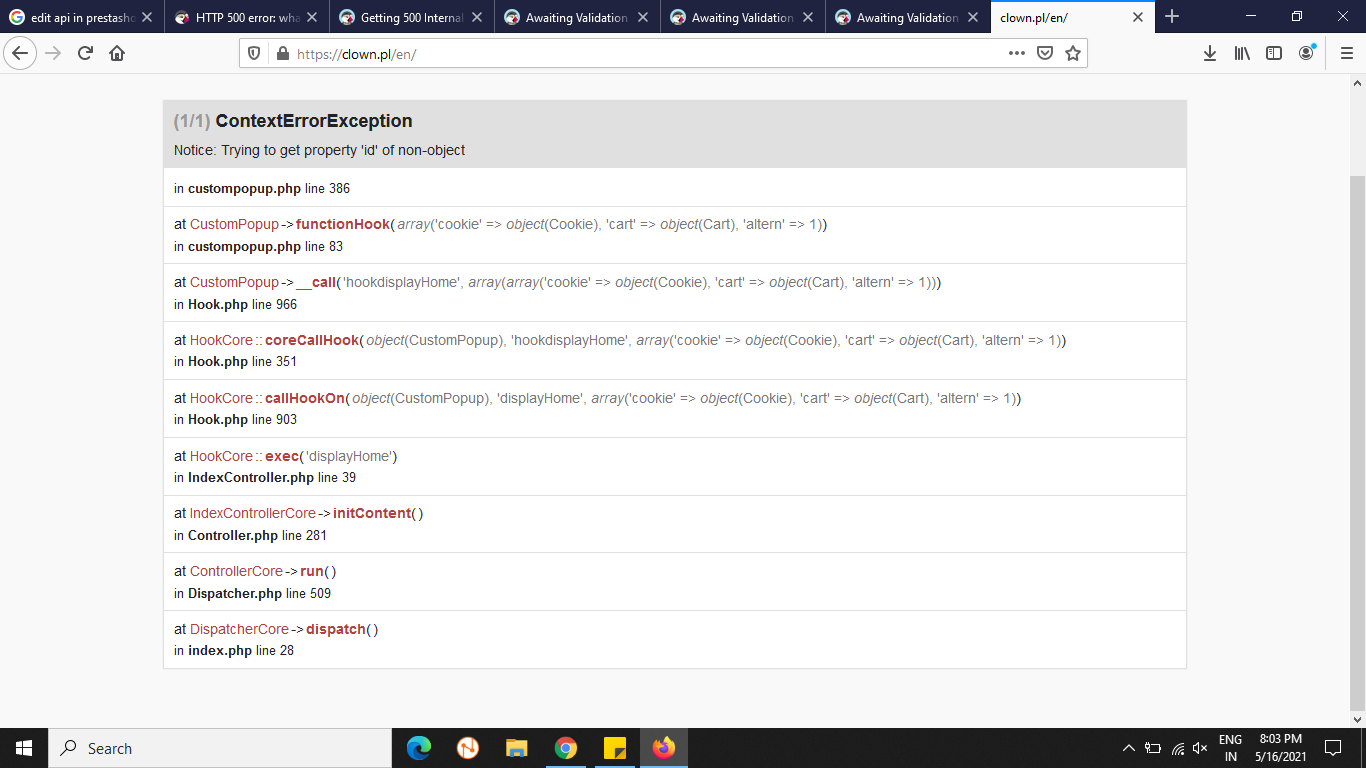

dev_darshan Posted May 16, 2021 Share Posted May 16, 2021 Oops! An Error Occurred The server returned a "500 Internal Server Error". Something is broken. Please let us know what you were doing when this error occurred. We will fix it as soon as possible. Sorry for any inconvenience caused. I don't Know what to do please help me out. i have above error in ADVANCED->API->EDIT API in admin panel i am using debug mode than showing below error. how to resolve this issue. Link to comment Share on other sites More sharing options...
JBW Posted May 17, 2021 Share Posted May 17, 2021 On 5/16/2021 at 4:32 PM, dev_darshan said: how to resolve this issue There seems to be a module "Custom Popup" causing the error. You can deactivate it and contact the developer to fix it. As it is only a notice it should also disappear as soon you deactivate debug mode. But I guess in the admin panel you will see a different error!? Link to comment Share on other sites More sharing options...
