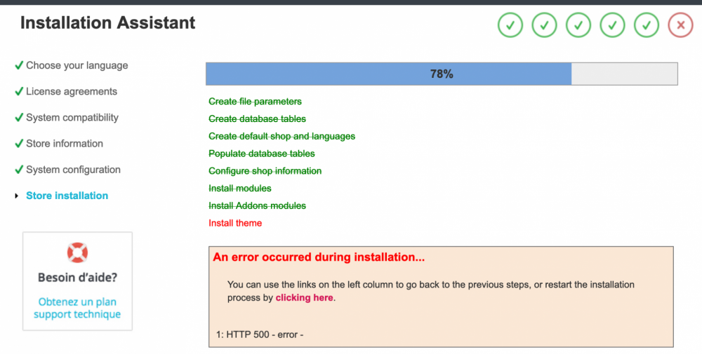

ChDUP Posted December 22, 2019 Share Posted December 22, 2019 Hi ! I try to install Prestashop 1.7.6.2 on my docker configuration. And I've always same error during the installation at the "Install theme" step.1: HTTP 500 - error - I've also try with 1.7.6.0 and same error. Thanks for your help ! Link to comment Share on other sites More sharing options...
Hhjgsur Posted December 30, 2019 Share Posted December 30, 2019 According to this documentation, you have to use at least PHP 7.1 to run Prestashop. I had the same problem and solved it by upgrading my PHP version on Wamp. Link to comment Share on other sites More sharing options...
selectshop.at Posted December 30, 2019 Share Posted December 30, 2019 You cannot install it by this way. You need to run install via command line if you want to use it on docker container. Here you will find a tutorial on how to setup Prestashop on docker: https://build.prestashop.com/news/prestashop-and-docker/ and https://github.com/PrestaShop/docker Installing Prestashop via CLI (command line): http://doc.prestashop.com/display/PS17/Installing+PrestaShop+using+the+command-line+script 1 Link to comment Share on other sites More sharing options...

ChDUP Posted December 31, 2019 Author Share Posted December 31, 2019 Il y a 19 heures, Hhjgsur a dit : According to this documentation, you have to use at least PHP 7.1 to run Prestashop. I had the same problem and solved it by upgrading my PHP version on Wamp. I was trying with last php 7-fpm image Il y a 17 heures, selectshop.at a dit : You cannot install it by this way. You need to run install via command line if you want to use it on docker container. Here you will find a tutorial on how to setup Prestashop on docker: https://build.prestashop.com/news/prestashop-and-docker/ and https://github.com/PrestaShop/docker Installing Prestashop via CLI (command line): http://doc.prestashop.com/display/PS17/Installing+PrestaShop+using+the+command-line+script I tried with Prestashop docker image but never succeeded (I don't remember the errors). But now it's ok with my method, with docker , Nginx, Traefik, like I wanted Thanks Link to comment Share on other sites More sharing options...
lazna Posted January 4, 2020 Share Posted January 4, 2020 Have same problem, trying to install Prestashop under Abyss Web Server. On step "Install theme" got Error 500. Prestashop 1.7.6.2, PHP 7.4.0 phppsinfo.php report NO problems. What am I doing wrong? Link to comment Share on other sites More sharing options...
endriu107 Posted January 4, 2020 Share Posted January 4, 2020 @lazna change your php to 7.2 Link to comment Share on other sites More sharing options...
lazna Posted January 4, 2020 Share Posted January 4, 2020 PHP downgraded to 7.2.18.0 but not help, still got error 500 in "Install theme" installation step. any other ideas? Link to comment Share on other sites More sharing options...
selectshop.at Posted January 4, 2020 Share Posted January 4, 2020 1) Read server error logs. 500 error are server errors. 2) Activate debug mode and read possible others errors you are having 3) Although phppsinfo is ok, you should check other minimal requirements to your server for to run Prestashop 1.7. Check also the permissions. Prestashop needs recursive write permissions on several directories (Folders 0755 and files 0644): /admin-dev/autoupgrade/, /app/logs, /app/Resources/translations, /cache, /config/themes, /download, /img, /log, /mails, /modules, /themes, /translations, /var Here: https://devdocs.prestashop.com/1.7/basics/installation/system-requirements/ or here: https://www.prestashop.com/forums/topic/884856-best-server-settings-for-prestashop-17-tested-in-production/ Link to comment Share on other sites More sharing options...
lazna Posted January 5, 2020 Share Posted January 5, 2020 (edited) As I enable fastcgi logging on server, the installation pass through successfully, after two days a spent with install, its....... funny. Another problem is after some action (e.g. category deletion), got text "No input file specified" (no html code, only this four words) on the screen. Fresh install, no changes except the deletion default categories. Do am I something wrong? Log record from according time https://pastebin.com/Yu5yz0kA or another same issue https://pastebin.com/gJiRydVN Edited January 5, 2020 by lazna (see edit history) Link to comment Share on other sites More sharing options...
