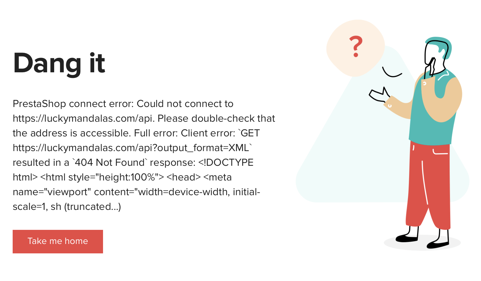

luckyman Posted December 3, 2019 Share Posted December 3, 2019 (edited) Cannot connect Printful Module on Prestashop 1.7.6.2. Module printful can't connect PrestaShop connect error: Could not connect to https://luckymandalas.com/api. Please double-check that the address is accessible. Full error: Client error: `GET Iam using a hosting with Apache server! Is there any one with same issue or knowledge of this error? Thanks! Edited December 3, 2019 by luckyman (see edit history) Link to comment Share on other sites More sharing options...
luckyman Posted December 3, 2019 Author Share Posted December 3, 2019 Looks like doesn't work with the 1 click install from cPanel add-on installers! I had to remove Prestashop integrally, create a new database, and install the download version, but the updated one. After that had to remove some redirects from .htacces file and enable SSL on site. It's now connected with Printfull account! Link to comment Share on other sites More sharing options...
