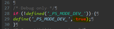

OK, jetzt kommt folgender Fehler:
Fatal error: Uncaught PDOException: SQLSTATE[HY000] [1045] Access denied for user 'db495950_20'@'localhost' (using password: YES) in /kunden/495950_96450/presta/vendor/doctrine/dbal/lib/Doctrine/DBAL/Driver/PDOConnection.php:43 Stack trace: #0 /kunden/495950_96450/presta/vendor/doctrine/dbal/lib/Doctrine/DBAL/Driver/PDOConnection.php(43): PDO->__construct('mysql:host=mysq...', 'db495950_20', '%%aeThGgh?e23', Array) #1 /kunden/495950_96450/presta/vendor/doctrine/dbal/lib/Doctrine/DBAL/Driver/PDOMySql/Driver.php(41): Doctrine\DBAL\Driver\PDOConnection->__construct('mysql:host=mysq...', 'db495950_20', '%%aeThGgh?e23', Array) #2 /kunden/495950_96450/presta/vendor/doctrine/dbal/lib/Doctrine/DBAL/Connection.php(360): Doctrine\DBAL\Driver\PDOMySql\Driver->connect(Array, 'db495950_20', '%%aeThGgh?e23', Array) #3 /kunden/495950_96450/presta/vendor/doctrine/dbal/lib/Doctrine/DBAL/Connection.php(942): Doctrine\DBAL\Connection->connect() #4 /kunden/495950_96450/presta/src/PrestaShopBundle/Kernel/ModuleRepository.php(70): Doctrine\DBA in /kunden/495950_96450/presta/vendor/doctrine/dbal/lib/Doctrine/DBAL/Driver/AbstractMySQLDriver.php on line 10
kommt doch nich ein Fehler wenn ich in der WARTUNG einen anderen Txt schreiben möchte:
User Warning: Base directory /kunden/495950_96450/presta/var/cache/dev/purifier does not exist,
please create or change using %Cache.SerializerPath
Exception
Logs 2
Stack Trace
Symfony\Component\Debug\Exception\ ContextErrorException
in vendor/ezyang/htmlpurifier/library/HTMLPurifier/DefinitionCache/Serializer.php (line 235)
HTMLPurifier_DefinitionCache_Serializer->_prepareDir(object(HTMLPurifier_Config)) in vendor/ezyang/htmlpurifier/library/HTMLPurifier/DefinitionCache/Serializer.php (line 125)
HTMLPurifier_DefinitionCache_Serializer->cleanup(object(HTMLPurifier_Config)) in vendor/ezyang/htmlpurifier/library/HTMLPurifier/DefinitionCache/Decorator.php (line 108)
