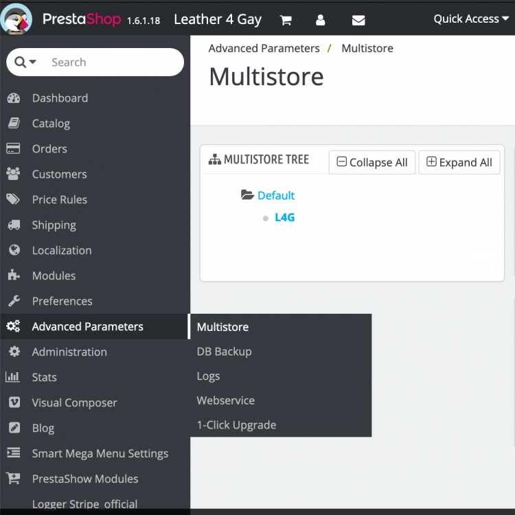

Lukasztom Posted November 28, 2019 Share Posted November 28, 2019 Hello I run my Prestashop 1.6.1.18 and in my back-end is missing menu left sub menus. In menu ADVANCED PARAMETRS (...backshop/index.php?controller=AdminSelfUpgrade....) I have only these 5 : - MultiStore - DB Backup - Logs - Webservice - 1-Click Upgrade Anyone can give me some advice how to get them back... Many thanks Lukasz Link to comment Share on other sites More sharing options...

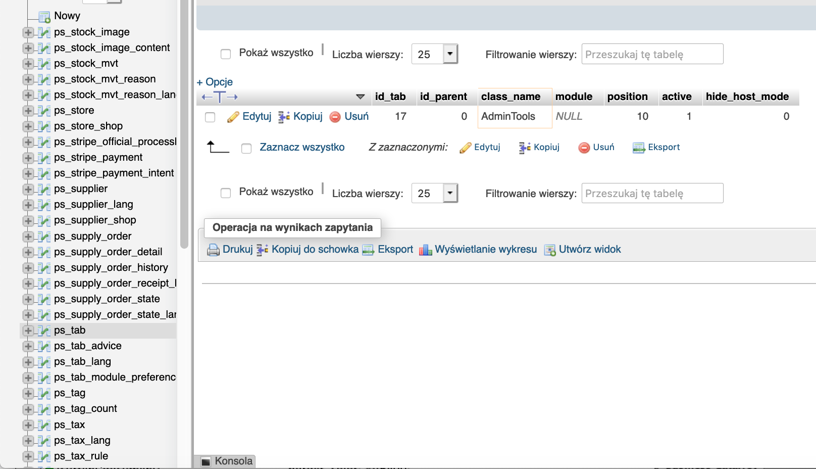

tuk66 Posted November 29, 2019 Share Posted November 29, 2019 What happened? You can check the menu items in the ps_tab* tables. The class for Advanced Parameters is AdminTools. Link to comment Share on other sites More sharing options...

Lukasztom Posted November 29, 2019 Author Share Posted November 29, 2019 Hello Thank you for help I've checked my table *ps_tab and I can see that : AdminTools -> column Active -> 1 I've attached my screengrabs... but can't see on my front-end -------------- NemoPS - How can i add from BACK ? Many thanks 57 minutes ago, NemoPS said: You can always add them back from the menus page, as long as you know the controller name. For performance it would be AdminPerformanceController. Link to comment Share on other sites More sharing options...

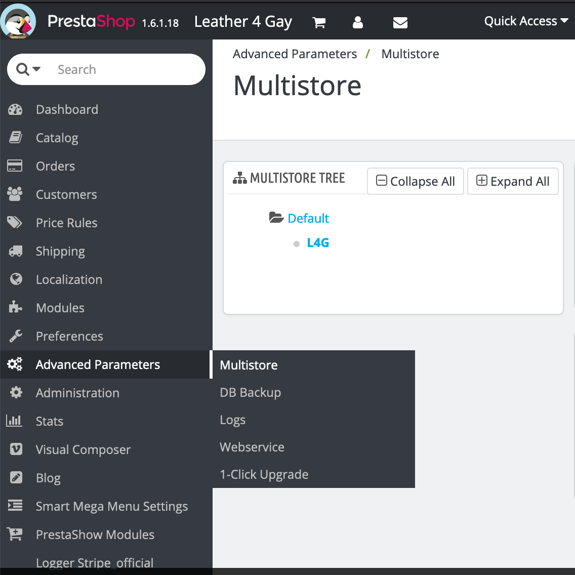

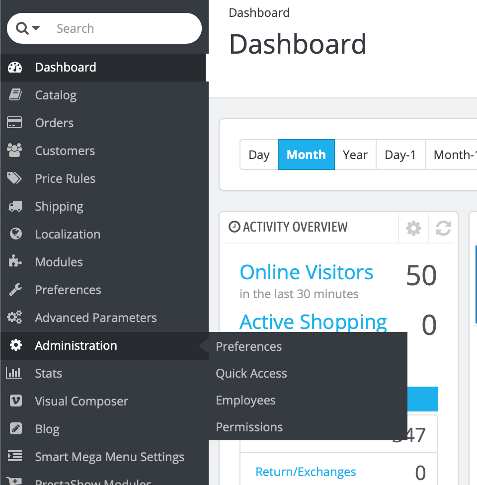

Lukasztom Posted December 2, 2019 Author Share Posted December 2, 2019 Thank u for reply The issue is that I cant see submenus called MENUS attached screen Thanks Link to comment Share on other sites More sharing options...
NemoPS Posted December 4, 2019 Share Posted December 4, 2019 ok, sorry, didn't notice that. Edit the url and write AdminTabs after controller=, like dmin929mzfuug/index.php?controller=AdminTabs&token=826cdbaaa110d6cc54fb7b9cc175eedc It will tell you the token is wrong, you can ignore the warning and continue Link to comment Share on other sites More sharing options...

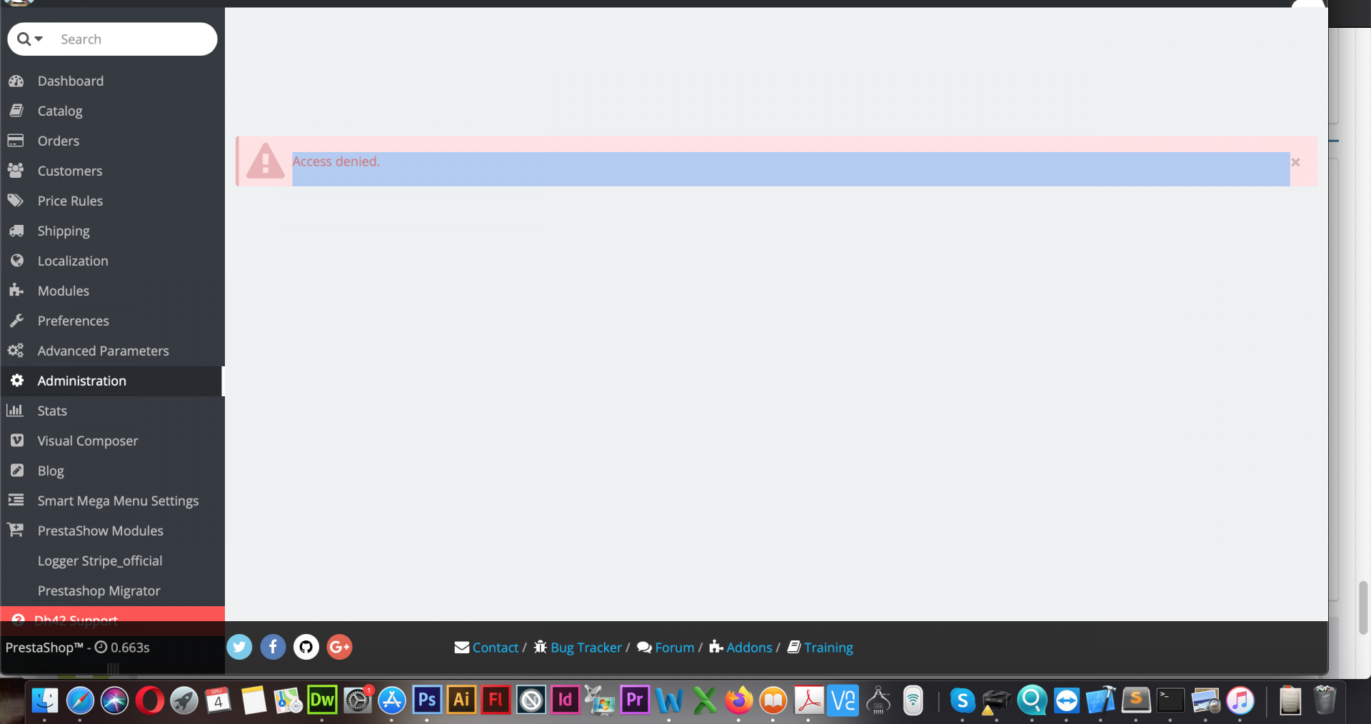

Lukasztom Posted December 4, 2019 Author Share Posted December 4, 2019 Hello Thank you for the reply I didnt like you wrote me but i got this alert message :"Access denied" attached screen Thanks Link to comment Share on other sites More sharing options...
NemoPS Posted December 6, 2019 Share Posted December 6, 2019 Hmm does your user have admin privileges? It looks like it doesn't. Check ps_employee and make sure the role is id 1, superadmin Link to comment Share on other sites More sharing options...
