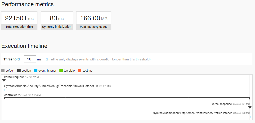

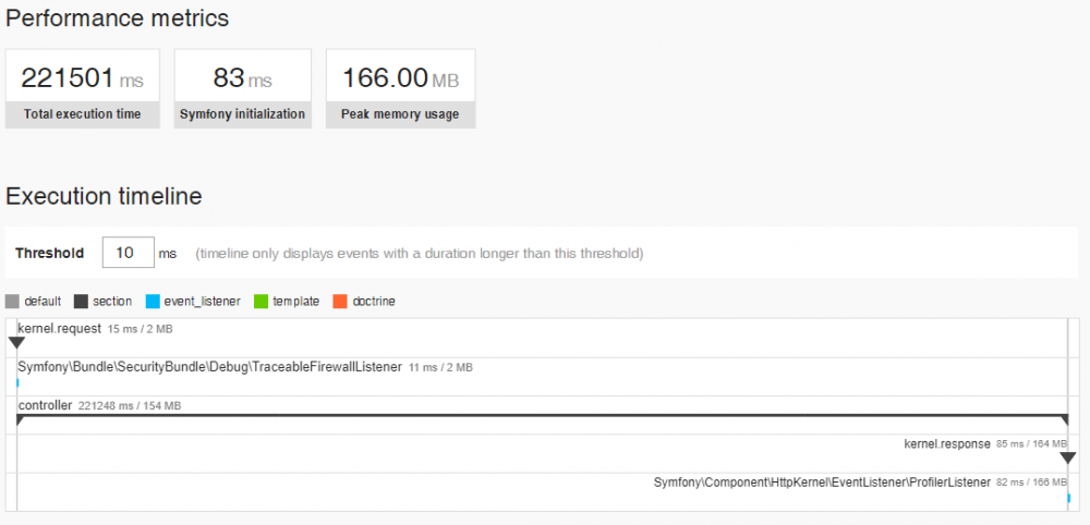

zanpo Posted November 22, 2019 Share Posted November 22, 2019 (edited) I'm confronting myself with a very slow admin after upgrading to PS 1.7.5.0 and even on 1.7.6.1, the same problem, when I try to update something from products (for example stock, or description or title) the "save" button takes forever to update the product. I enabled dev mode, and I get this performance result (when updating attribute stock): Quote Performance metrics 221501 ms Total execution time From the attached image, "controller" eats up a lot of time, but I don't know what it refers to. Any ideas why is this happening, the store has around 5500 products with attributes and 60 categories. Server specs: Quote nginx/1.16.1 PHP: 7.2.24 memory limit: 1024M execution time: 600s Edited November 22, 2019 by zanpo (see edit history) Link to comment Share on other sites More sharing options...

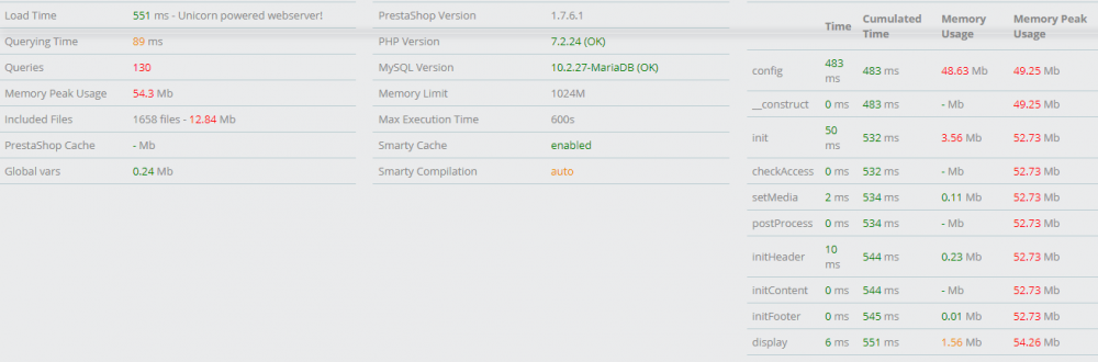

zanpo Posted November 24, 2019 Author Share Posted November 24, 2019 (edited) Thanks, I've tried it, but I don't see any useful information, the timings here are in ms: Edited November 24, 2019 by zanpo (see edit history) Link to comment Share on other sites More sharing options...

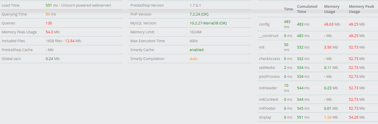

tuk66 Posted November 25, 2019 Share Posted November 25, 2019 So the total execution time is 221 seconds even it says the loading time is 551 ms? Link to comment Share on other sites More sharing options...
