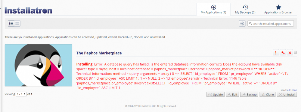

lse123 Posted November 11, 2019 Author Share Posted November 11, 2019 I followed the settings recommended but same error --- nothing written in database --- before start installing --i have make the changes to PHP 7.2 and restarted Apache... but again same error see below????? what to do??? Link to comment Share on other sites More sharing options...

lse123 Posted November 11, 2019 Author Share Posted November 11, 2019 Installing: Error: A database query has failed. Is the entered database information correct? Does the account have available disk space? type = mysql host = localhost database = paphos_marketplace username = paphos_market password = **HIDDEN** Technical information: method = query arguments = array ( 0 => 'SELECT `id_employee` FROM `ps_employee` WHERE `active`=\'1\' ORDER BY `id_employee` ASC LIMIT 1', 1 => NULL, 2 => 'id_employee',) errstr = Technical Error: 1146 Table 'paphos_marketplace.ps_employee' doesn't existSELECT `id_employee` FROM `ps_employee` WHERE `active`='1' ORDER BY `id_employee` ASC LIMIT 1 Again same error... are you recommend check any MySQL/MariaDB settings... ? Link to comment Share on other sites More sharing options...
