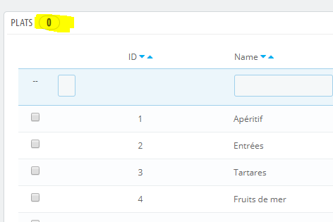

Hello,
I developped a module that deals with custom entities that I created (PS 1.6).
Everything is working fine except one small detail...
I created the classes and admin controllers for my entities and I'm able to add / edit /delete records from the back office.

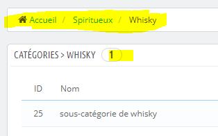

When I go to an entity called "appellations", I can see the list of the "appellations" that were created and the number of "appellations".
BUT when I do the same thing with another entity, called "plats", the number of plats is always "0". The difference between appellations and plats is that "plats" is a kind of hierarchical entity, which means one "plat" can have a parent. It's kind of like categories. So when I click on "plats" in admin, I don't see the list of all plats but instead all the plats that have id_parent = 0.
This is working great except that the number displayed is "0" instead of the real number of the list that's dislayed.
And then if I click on one element in my list, it displays ok all the "children" of this "plat", but still the number is 0. And I have no breadcrumb, which is the second issue that I have.
I really need some help of someone who is used to develop modules. I'm sure it's not a big issue, but I'm stuck.
I can display my code if needed.
Thanks a lot.

I think the clas is ok. Now the controller, which must be not ok somewhere, but I don't know where :)

Like I explained I can see the list of plats that have no parent, it's ok, but the number displayed is "0 plat', while it's not true.
And then when I click on one of the plats, i can see it's children, this part works fine also, but the number is still "o plat" and worse, I have no breacrumb which is very upsetting. I need to have breadcrumbs here or else the user doesn"t always knows where he is...
Thanks for your help !
I would use a recursive function to get the children, I might have missed it in the code but it looks like you might be getting them all together. Get the root, then all its children, and so on, until the list of children is exhausted. SO if you have id = 0, get all of the ones with id_parent = 0, iterate, then get children for each. How you display them will change of course, I am not sure how the helper deals with it outside categories as I never used it.
Hello Nemo,
Thanks for your answer :)
Actually I don't have any issue with getting the children because as I tried to explain, dirst I get the list of all entities with no parent, and it's working fine.
Then when I click on one of them, it shows me its children, and so on.
So everything is working fine.
The only issue that I have is related to the breadcrumb and the total that's displayed.
As you can see I have more then one '"plat" and the number is not correct :
Other issue when I go down the children and grand-children, the breadcrumb doesn't appear so I never know where I am and I can't navigate (and the number is still 0).
I'm just trying to recreate what happens with categories :
As you can see here I have a breadcrumb displayed (I don't know how to get this) which is useful to go up in the tree, and also the number is correct.
I hope it ios clearer now...
