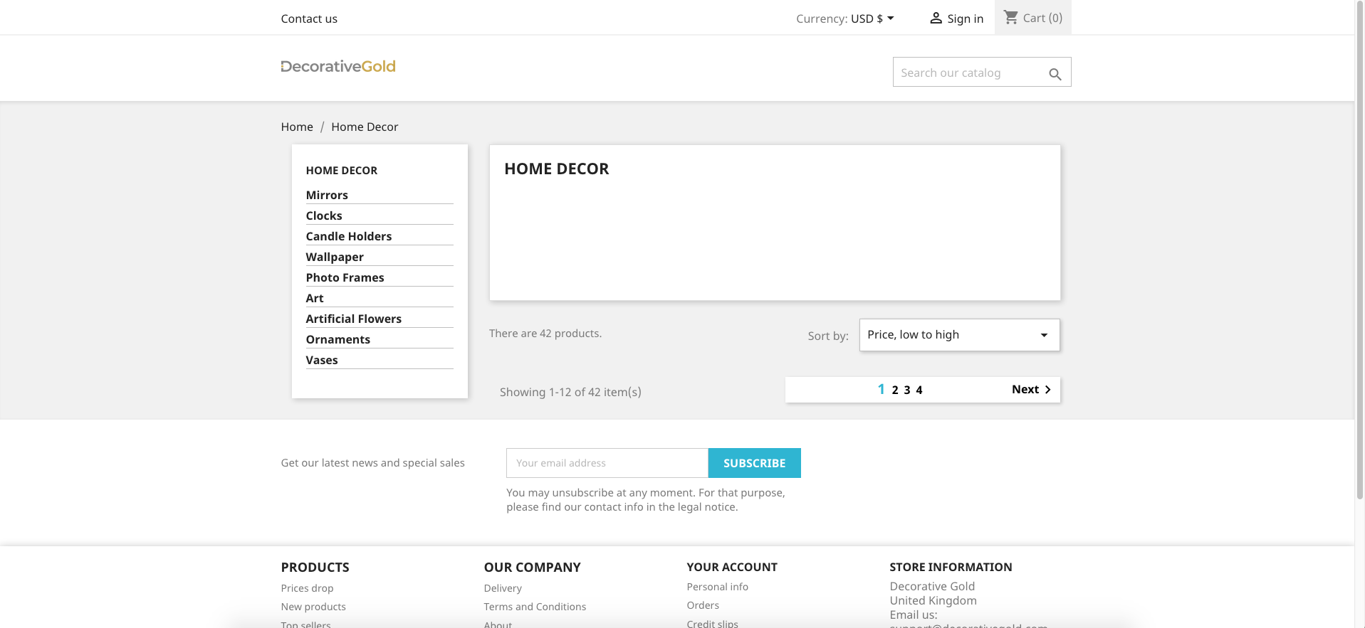

zomex Posted November 9, 2019 Share Posted November 9, 2019 Hello all, For some reason sort by price does not work on my installation. I wondered if this was due to using combinations and setting the main product to $0. But it efforts all products with or without combinations. As you can see there are products listed and the pagination but no products displayed. See attached for some screenshots. Has anyone faced this same issue? Thanks, Jack Link to comment Share on other sites More sharing options...

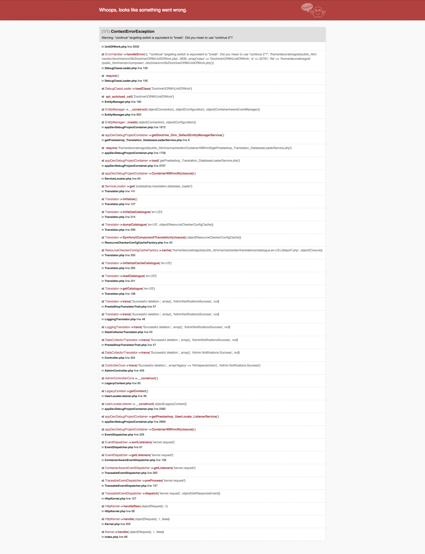

zomex Posted November 11, 2019 Author Share Posted November 11, 2019 I found the following: Switched PHP from V7.3 to V7.2, the admin page now loads as normal but the same filter error remains. There's no error shown with debugging enabled. Link to comment Share on other sites More sharing options...

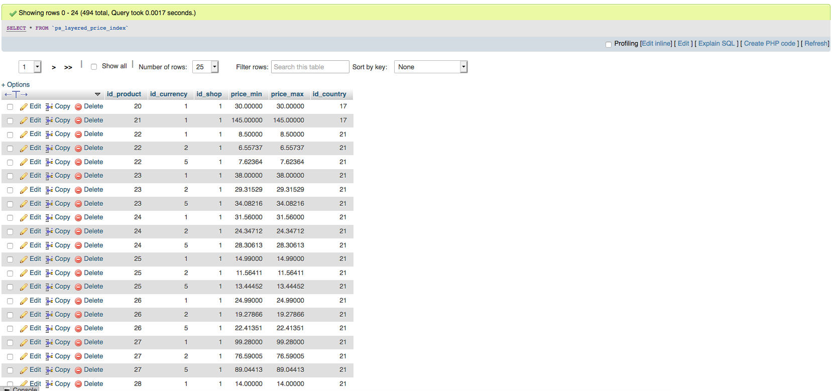

PCQUATRO Posted November 12, 2019 Share Posted November 12, 2019 2 hours ago, zomex said: Same issue with manually created products. Check to see if you have a table in your database named xx_layered_price_index and if it exists check it´s contentes... Best Regards Link to comment Share on other sites More sharing options...
zomex Posted November 12, 2019 Author Share Posted November 12, 2019 36 minutes ago, PCQUATRO said: Check to see if you have a table in your database named xx_layered_price_index and if it exists check it´s contentes... Best Regards Yes I do have it, seems to contain every product. See below. Thanks Link to comment Share on other sites More sharing options...
PCQUATRO Posted November 12, 2019 Share Posted November 12, 2019 12 minutes ago, zomex said: Yes I do have it, seems to contain every product. See below. Than your issue is not the same as the one i´ve been able to reproduce, anyway it could be related to the module you used for importing products, it could have messed up something, so the best thing to do is start over... Best Regards Link to comment Share on other sites More sharing options...

zomex Posted November 13, 2019 Author Share Posted November 13, 2019 (edited) Some more investigation. Checking ps_layered_price_index it's full of data. On my dev install where the feature is working the ps_layered_price_index table is empty. When I enable tax for a product on the live site it adds 3 rows to ps_layered_price_index. I'm wondering if perhaps some of the data is invalid or glitched in that table? Also note that I have 3 currencies so it appears to be adding 3 rows per category. I'm wondering if by selecting the tax it's focing this table to update with the 3 rows correcting the issue (which may be rows missing from that table?). Edited November 13, 2019 by zomex (see edit history) Link to comment Share on other sites More sharing options...
PCQUATRO Posted November 13, 2019 Share Posted November 13, 2019 1 hour ago, zomex said: When I enable tax for a product on the live site it adds 3 rows to ps_layered_price_index. I'm wondering if perhaps some of the data is invalid or glitched in that table? Also note that I have 3 currencies so it appears to be adding 3 rows per category. I'm wondering if by selecting the tax it's focing this table to update with the 3 rows correcting the issue (which may be rows missing from that table?). What i´ve learned is that table keeps the price index used for sorting by price, so the products must be there. That table is populated by rebuilding the index on the faceted search as i posted earlier. The table also receive rows as you save products... It can have something to do with the fact that you have 3 currencies, i only have one... I might try to add some currencies and see how it goes... Best Regards Link to comment Share on other sites More sharing options...
zomex Posted November 13, 2019 Author Share Posted November 13, 2019 34 minutes ago, PCQUATRO said: What i´ve learned is that table keeps the price index used for sorting by price, so the products must be there. That table is populated by rebuilding the index on the faceted search as i posted earlier. The table also receive rows as you save products... It can have something to do with the fact that you have 3 currencies, i only have one... I might try to add some currencies and see how it goes... Best Regards Thanks, Looks like the data is correct in the DB at least with that table. Another strange situation, it is working in Google Chrome and Safari but not Firefox. I cleared my browser cache and the error remains in Firefox. Perhaps it's a browser issue. But then I have tested my dev domain (all stock) and the issue shows for me in all browsers: https://zomex.net/prestashop/index.php?id_category=8&controller=category&id_lang=2 It just seems to be so tempermental. As it's working in Chrome and Safari I am hoping that my install itself is fine and this is more of a glitch/bug with the browser but then it not working at all on my dev install contradicts that. Link to comment Share on other sites More sharing options...

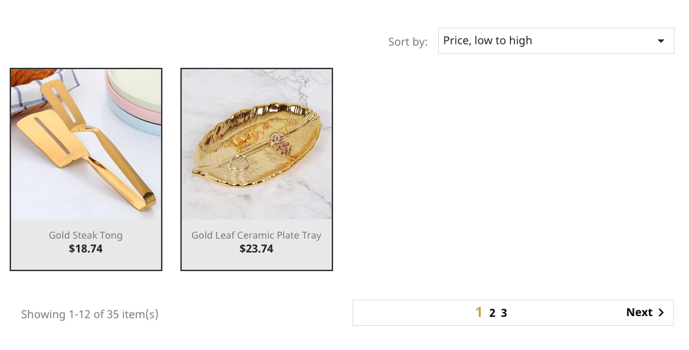

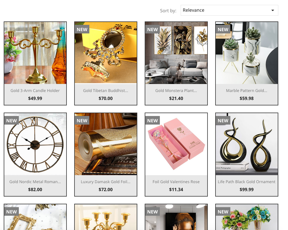

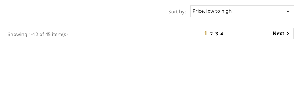

PCQUATRO Posted November 13, 2019 Share Posted November 13, 2019 6 hours ago, zomex said: Another strange situation, it is working in Google Chrome and Safari but not Firefox. I cleared my browser cache and the error remains in Firefox. Perhaps it's a browser issue. I have no issue whatsoever in any browser in 3 shops! all browsers sort the products by price as they should... 6 hours ago, zomex said: But then I have tested my dev domain (all stock) and the issue shows for me in all browsers: https://zomex.net/prestashop/index.php?id_category=8&controller=category&id_lang=2 That´s because you need to index prices in the faceted search module, or resave them... Best Regards Link to comment Share on other sites More sharing options...
selectshop.at Posted November 13, 2019 Share Posted November 13, 2019 Take into consideration that it could be a firefox problem. Which is the URL of your site ? Sorry found it above. Link to comment Share on other sites More sharing options...
selectshop.at Posted November 13, 2019 Share Posted November 13, 2019 From what I see you are not using friendly URL's. Tried to set friendly URL's as well ? Same problem then ? BTW with Opera prices are not sorted as well. Editted: OK I see the problem. On my latest installation on own server I'm having same problem. Seems that this is a bug. Which PS-Version are you using ? Which php-version ? Which SQL ? Link to comment Share on other sites More sharing options...

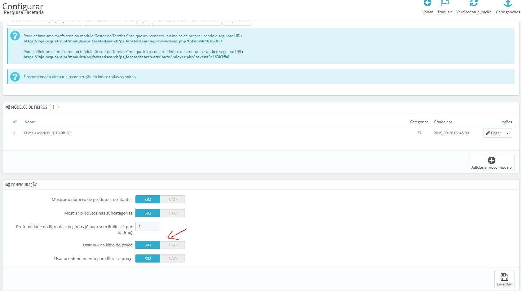

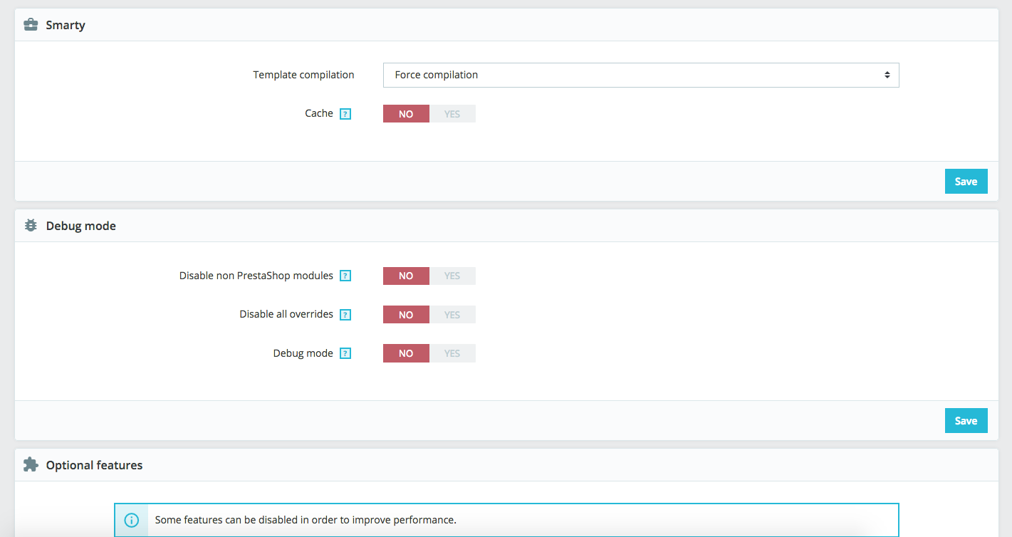

selectshop.at Posted November 13, 2019 Share Posted November 13, 2019 As I was having same problem I did the following to manage it: Reindexed the products: Shop parameters -> Search -> indexing and also rebuildt the module like PCQuattro told before: module manager -> facetted search module -> configure (used all possible features there - index all missing prices, rebuild entire price index and clear cache): Now it's working for me as well: Link to comment Share on other sites More sharing options...
PCQUATRO Posted November 13, 2019 Share Posted November 13, 2019 17 hours ago, zomex said: Currently all of my products do not have a tax enabled. I have now found out that if I enable tax for a product it then will show for the price filter. See attached. I tested editing and saving a product but it had no effect, the only way it works is with a tax selected. How do you have this option??? Best Regards Link to comment Share on other sites More sharing options...

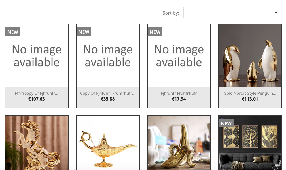

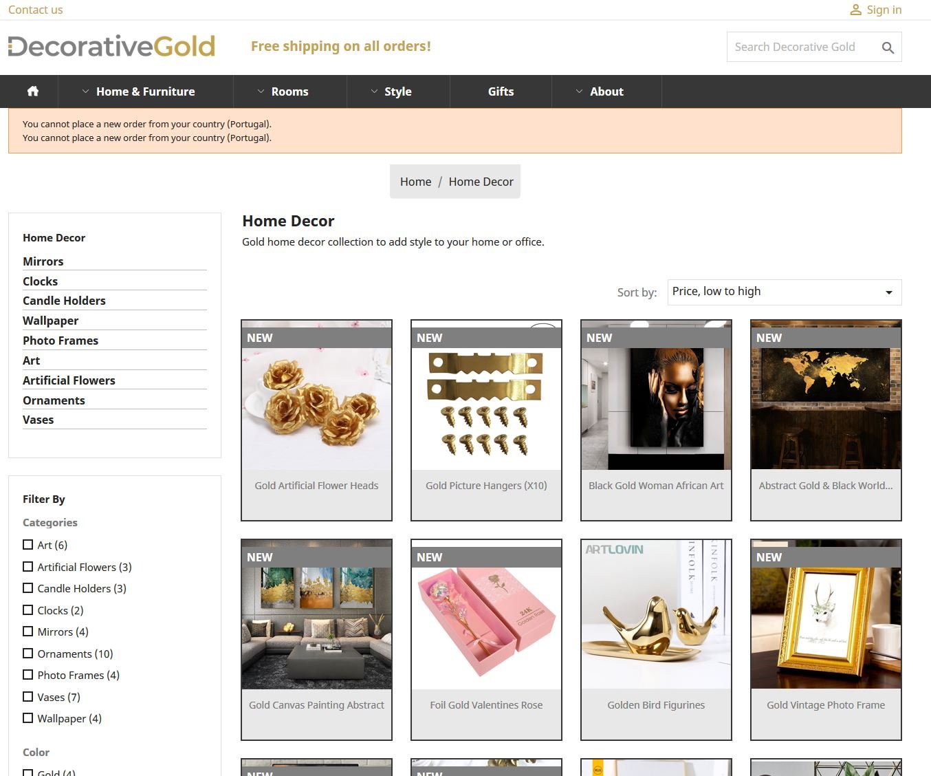

zomex Posted November 13, 2019 Author Share Posted November 13, 2019 (edited) Thanks for the replies everyone, The zomex.net domain was just a test of a stock install. My main install is in maintenance mode but I have now turned this off and added a directory login: URL: https://decorativegold.com/ --------------- Here's my stats PrestaShop version: 1.7.6.1 Server software version: LiteSpeed PHP version: 7.2.24 Memory limit: 512M MySQL version: 10.3.18-MariaDB-log-cll-lve MySQL server: 127.0.0.1 The browser I'm using: Mozilla/5.0 (Macintosh; Intel Mac OS X 10.10; rv:70.0) Gecko/20100101 Firefox/70.0 --------------- @selectshop.at I have made all of the suggested changes, the issue remains in Firefox, that also includes after clearing my browser cache. After completing these steps the the tax enabled products that were showing with the filter on are no longer showing. This is with or without the tax setting enabled in the search module. @PCQUATRO Yes I do have that option, it looked promising as it works with tax enabled but changing that setting on or off the issue remains. --- Google Chrome is working perfectly. So it appears to be specific to my Firefox. Edited November 13, 2019 by selectshop.at Login details to your BO deleted by mod. (see edit history) Link to comment Share on other sites More sharing options...

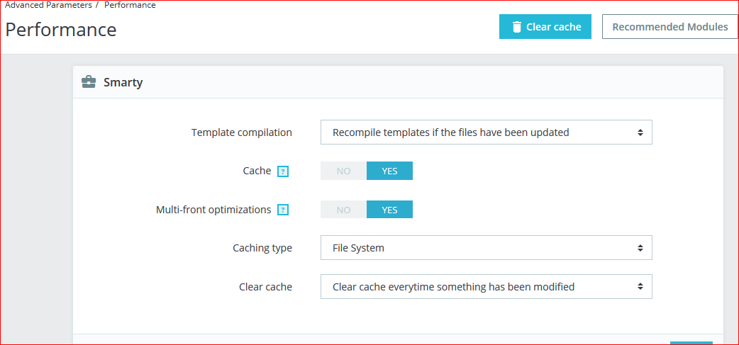

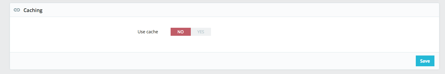

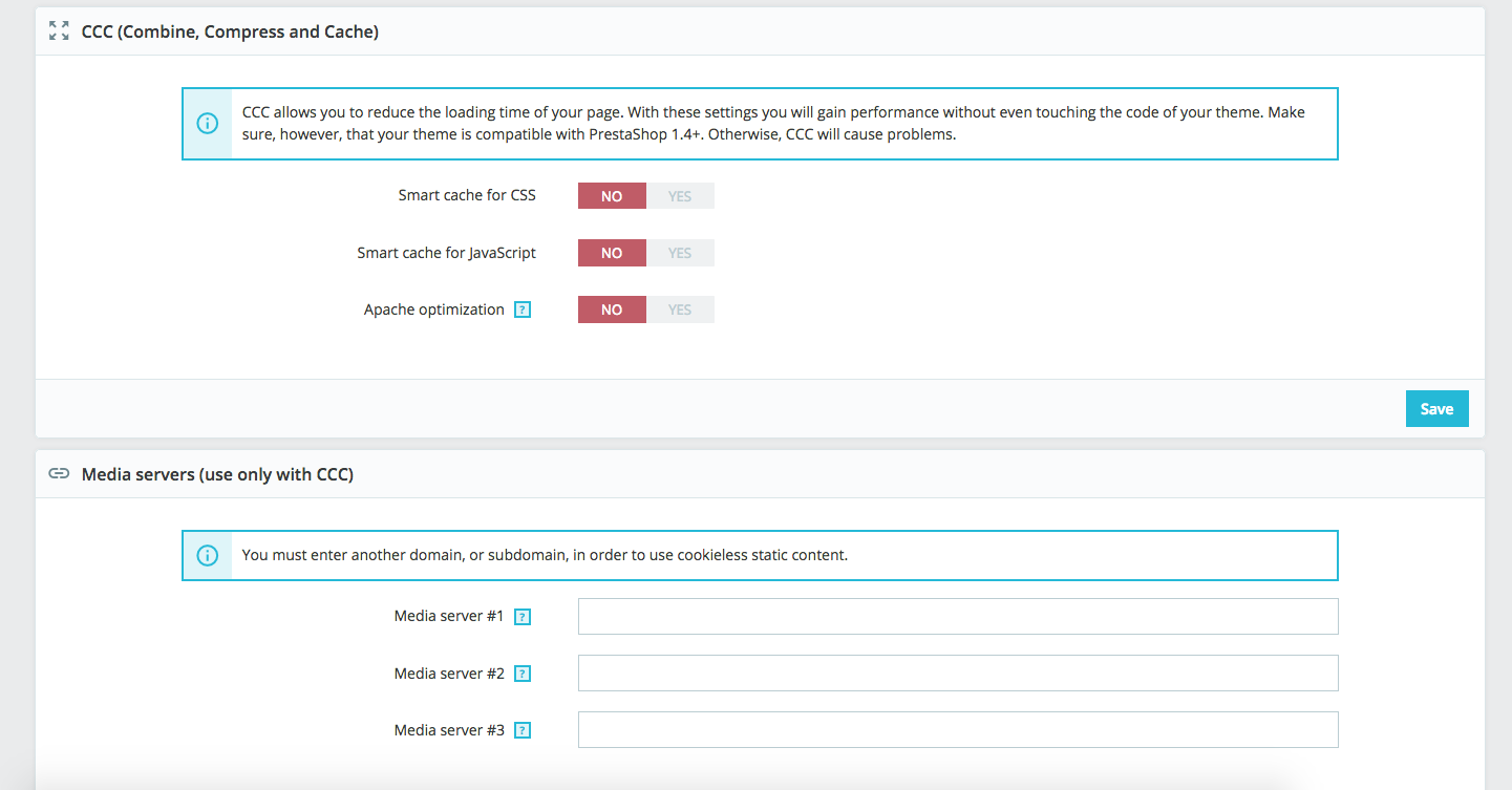

selectshop.at Posted November 13, 2019 Share Posted November 13, 2019 I think your problem is a cache problem. As I told before with Opera your "demo" shop is as well not working. Why Chrome only, I cannot say. Perhaps you are using something special on your server or shop. Overrides are disabled ? CCC options are enabled/disabled ? Link to comment Share on other sites More sharing options...
zomex Posted November 13, 2019 Author Share Posted November 13, 2019 5 minutes ago, selectshop.at said: I think your problem is a cache problem. As I told before with Opera your "demo" shop is as well not working. Why Chrome only, I cannot say. Perhaps you are using something special on your server or shop. Overrides are disabled ? CCC options are enabled/disabled ? Is it working for you in any browsers? overrides enabled, all caching is disabled until I push it live. Link to comment Share on other sites More sharing options...
selectshop.at Posted November 13, 2019 Share Posted November 13, 2019 Smarty correct setting is: Disable all overrides = Yes. On my "demo shop" is now working with all browsers. Opera, FF, Chrome and MS Edge. Link to comment Share on other sites More sharing options...
zomex Posted November 13, 2019 Author Share Posted November 13, 2019 (edited) 15 minutes ago, selectshop.at said: Smarty correct setting is: Disable all overrides = Yes. On my "demo shop" is now working with all browsers. Opera, FF, Chrome and MS Edge. This is the correct settings for a live site. The site is in development. I have tested your settings and it does not fix the issue. I do appretiate the time you've given to checking this for me. But I have to say that Prestashop itself is not giving me much confidence I am really close to scrapping it and going with Magento. Not just this issue but no ability to set a tax as exclusive is very concering as it's basic functionality for any ecommerce platform: Prestashop seems to be all about selling 3rd party modules, which i understand and support as a business model until I find out that even to enable Google re-capcha requires a paid module. Edited November 13, 2019 by zomex (see edit history) Link to comment Share on other sites More sharing options...

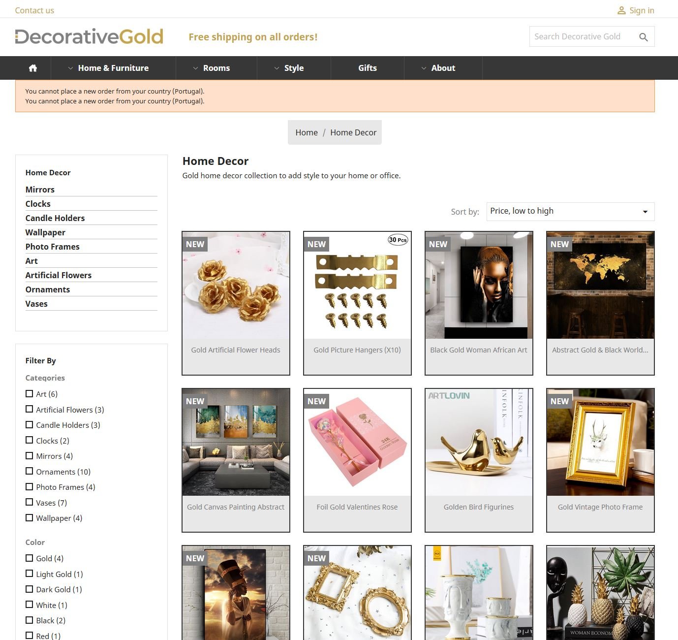

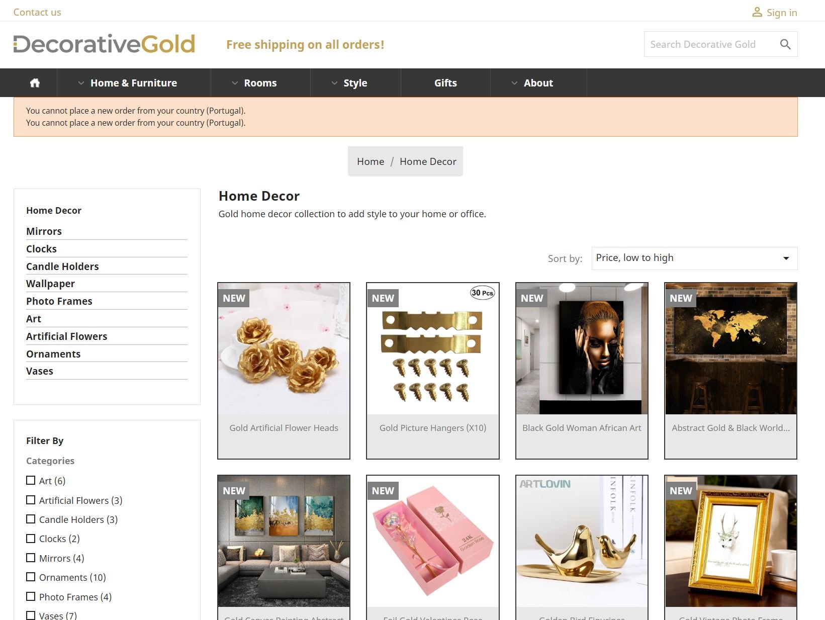

PCQUATRO Posted November 13, 2019 Share Posted November 13, 2019 8 hours ago, zomex said: My main install is in maintenance mode but I have now turned this off and added a directory login: URL: https://decorativegold.com/ It asks for a password! Best Regards Link to comment Share on other sites More sharing options...
zomex Posted November 13, 2019 Author Share Posted November 13, 2019 42 minutes ago, PCQUATRO said: It asks for a password! Best Regards I added the login but someone removed it from my reply. The login was just to load the website not to access anything. I have disabled the login so you can take a look. I am still looking for a solution mostly to the tax situation: https://www.prestashop.com/forums/topic/1008217-best-way-to-setup-vat-for-uk-business/ I would like to get to the bottom of this bug but it is not vital to launch where as the tax is. Here is my website: https://decorativegold.com/ Link to comment Share on other sites More sharing options...

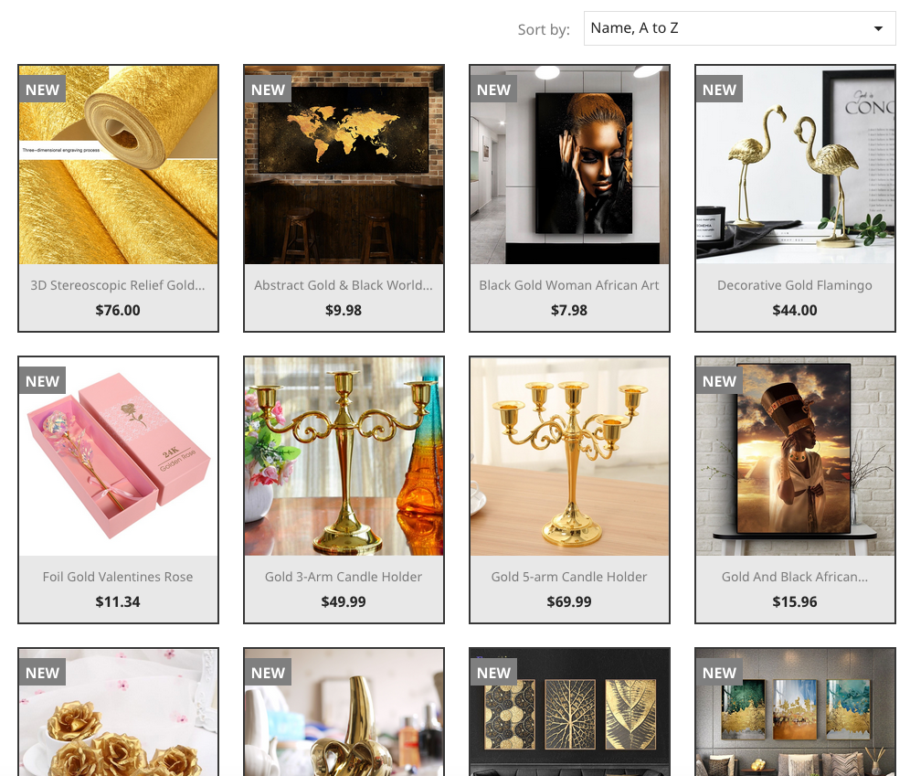

PCQUATRO Posted November 13, 2019 Share Posted November 13, 2019 Despite not having the prices for Portugal (unless you enable it) it looks like it sorts just fine in all browsers! Edge... Chrome... Firefox... Best Regards Link to comment Share on other sites More sharing options...
zomex Posted November 14, 2019 Author Share Posted November 14, 2019 Thanks for testing that for me, it must be an issue on my end or a glitch of some kind. I will forget about this now and move on knowing that it will work for some. --- Strangely I have Portugal enabled as a country so I will have to test why it shows the note that you can't order from Portugal. Link to comment Share on other sites More sharing options...
Funieru Bogdan Posted May 19, 2020 Share Posted May 19, 2020 On 11/13/2019 at 11:21 AM, selectshop.at said: As I was having same problem I did the following to manage it: Reindexed the products: Shop parameters -> Search -> indexing and also rebuildt the module like PCQuattro told before: module manager -> facetted search module -> configure (used all possible features there - index all missing prices, rebuild entire price index and clear cache): Had the same issue, the Cron wasn't firing properly, i had rebuilt the index and everything started to work properly. thanks !!! Link to comment Share on other sites More sharing options...
