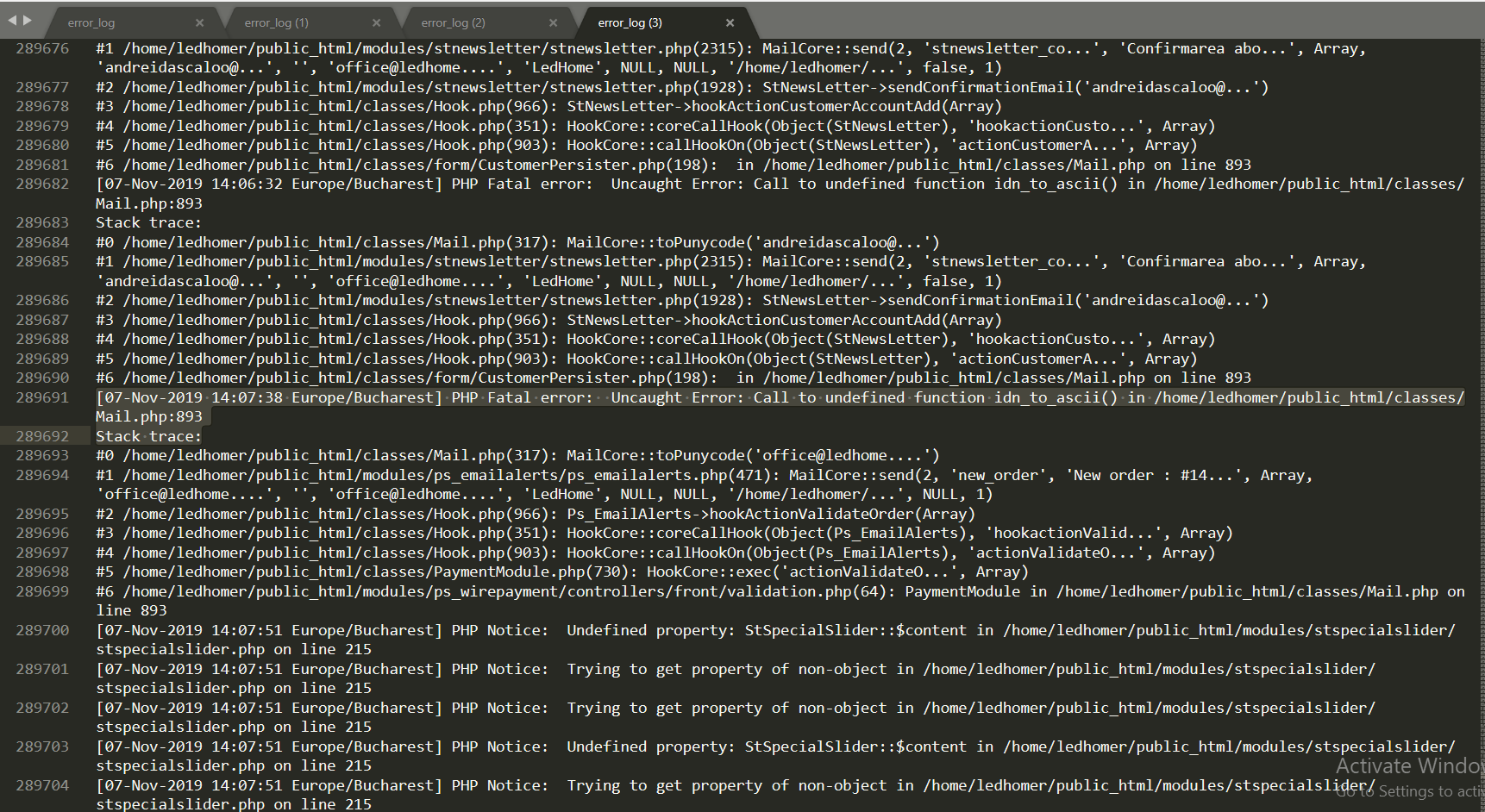

IoanT Posted November 7, 2019 Author Share Posted November 7, 2019 (edited) Am atasat erorile aparute cand s-a incercat o comanda Edited November 7, 2019 by IoanT (see edit history) Link to comment Share on other sites More sharing options...
Marius05 Posted November 7, 2019 Share Posted November 7, 2019 Pentru inceput: idn_to_ascii nu este activa. Vorbeste cu cei de la host sa o activeze. Sau vezi daca o poti activa tu din cpanel. Dupa aceea revin-o cu un error_log fresh. dupa ce ai incercat sa faci o comanda. Link to comment Share on other sites More sharing options...
