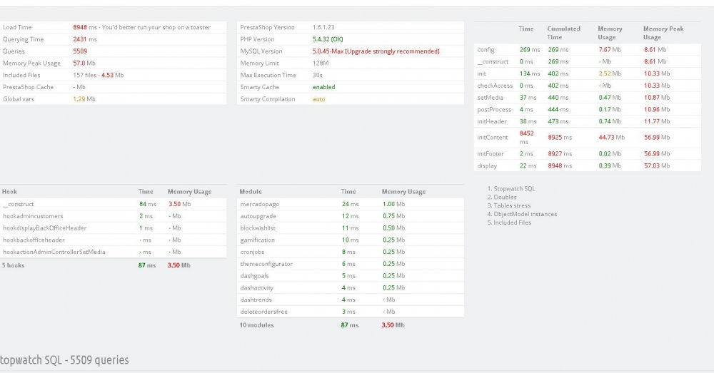

gaston22 Posted October 30, 2019 Author Share Posted October 30, 2019 Thanks Musicmaster, now I just downloaded your prestools, I think it's fantastic, very good job! Hi Razaro: 1. If I have enabled it as this page says: https://dh42.com/blog/prestashop-debug-profiling/ it should be loooong list of queries. You could make a screenshot of result. 2. I don't have any mailchimp module installed I attached the first part, because everything else is too long: This customer has 4 carts and the total of 4 cart items is 78 items- Link to comment Share on other sites More sharing options...
razaro Posted October 30, 2019 Share Posted October 30, 2019 Thank you for sharing screenshot. And that shows old PHP 5.4 and MySQL 5.0 plus just bare minimum of 128M of memory limit. Not like you mention "PHP version: 7.0.33-0 + deb9u5 Memory limit: 1024M Max execution time: 240" Strange maybe bug in profiling. You should check in Advance Parameters > Configuration information what is says But you should check also part after your screenshot, so after Stopwatch SQL - 5509 queries you could scroll down and see if any of lines on far right have red number that stands out. You did not replay about vouchers / catalog/cart rules. Do you have lot of those defined ? Link to comment Share on other sites More sharing options...

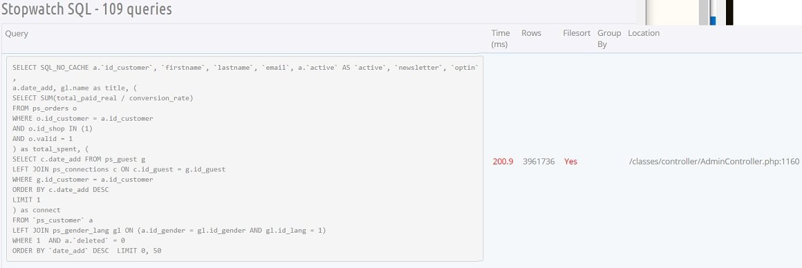

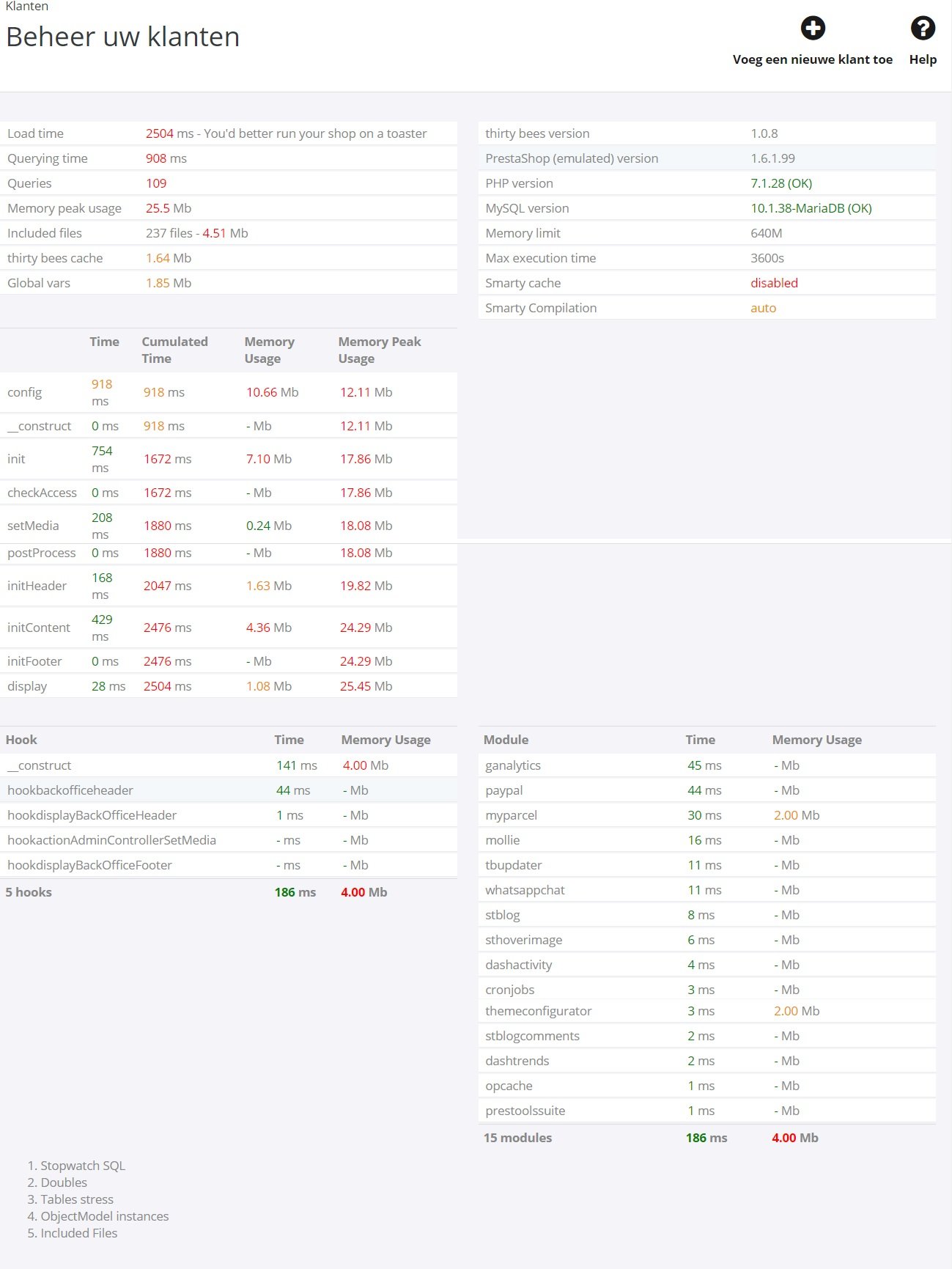

musicmaster Posted October 31, 2019 Share Posted October 31, 2019 (edited) It evades me on which page you are. Are you on the customer page - what shows 50 customers at a time? Or are you exporting a complete csv list of customers. I checked my Customers page and it doesn't use the cart_product table at all - while in you pictures it is the top consumer. So I get the impression that you have some module that adds extra information. As you seem a fan of not telling too much I will add some of my statistics in a webshop where customers have smaller and less orders so that you can compare. This is an old copy of an existing shop: Here are my top tables from Tables stress: And here is my top query - including the information that you see when you scroll to the right: Edited October 31, 2019 by musicmaster (see edit history) Link to comment Share on other sites More sharing options...
