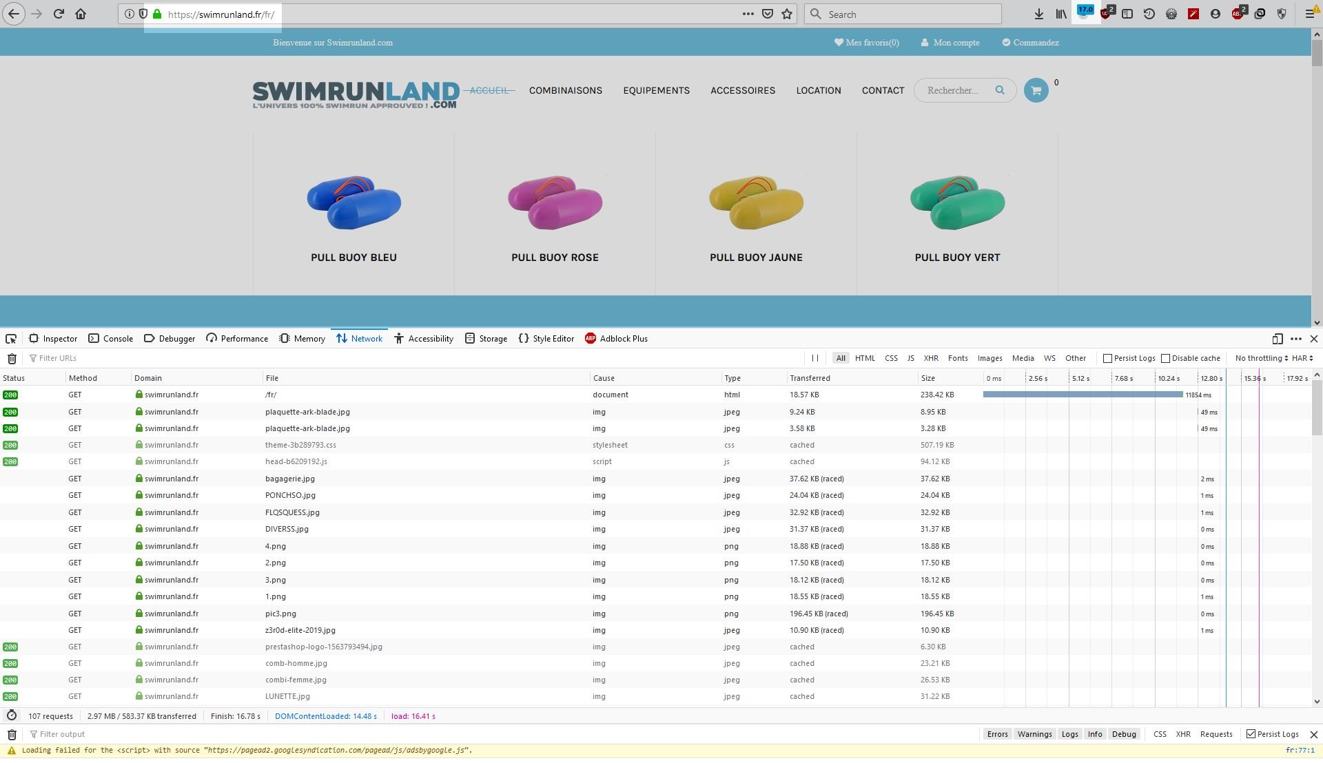

ghaitoute Posted October 24, 2019 Share Posted October 24, 2019 Hello everybody, i don't know why Is My Website Running Slow in english version : https://swimrunland.fr/en/ i try to analyse it via GTMETRIX here it is the result: https://gtmetrix.com/reports/swimrunland.fr/gxMjRMaB Can anybody help me please to understand what i have to do to fix this problem? Thank you so much Link to comment Share on other sites More sharing options...
Alex Posted October 24, 2019 Share Posted October 24, 2019 I have tried loading your website in French and in English. And yes, the English version of your website is running extremely slow. About 31 seconds to load. If that ain't a conversion killer then I don't know either ;-). But your French version ain't very fast either. Are you using caching. And what version of PHP are you using? If it is PHP 5.x without caching, the slow performance would be explainable. PrestaShop is a nice product. But it has not exactly been written with performance in mind 😂😂 Link to comment Share on other sites More sharing options...

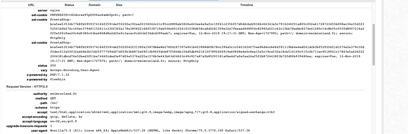

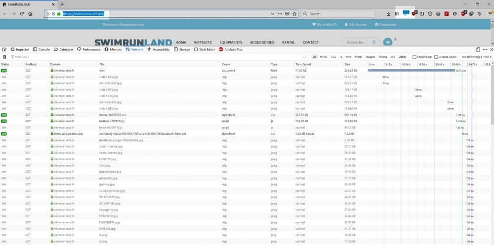

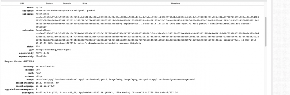

ghaitoute Posted October 24, 2019 Author Share Posted October 24, 2019 9 minutes ago, Alex said: I have tried loading your website in French and in English. And yes, the English version of your website is running extremely slow. About 31 seconds to load. If that ain't a conversion killer then I don't know either ;-). But your French version ain't very fast either. Are you using caching. And what version of PHP are you using? If it is PHP 5.x without caching, the slow performance would be explainable. PrestaShop is a nice product. But it has not exactly been written with performance in mind 😂😂 Hello dear Alex, thank you for your help. yes i'm using caching with the CCC option ... the php version is PHP/7.1.32, please find in the attched file some screen shot about the header of the English version, if it can help. Link to comment Share on other sites More sharing options...

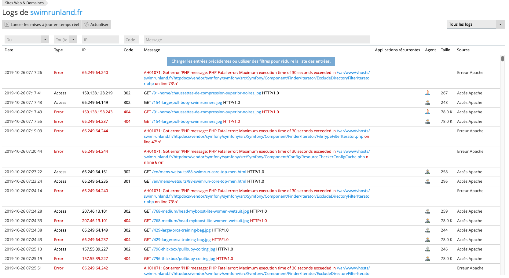

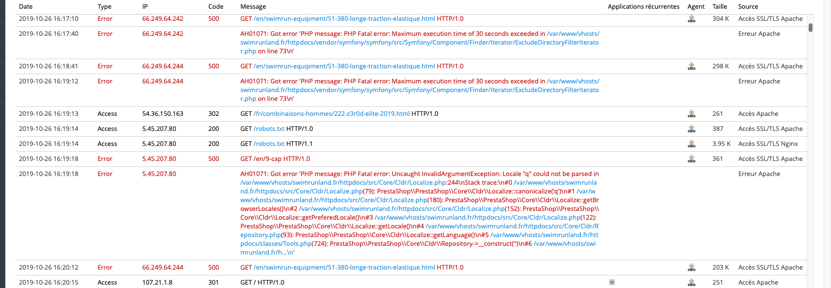

ghaitoute Posted October 26, 2019 Author Share Posted October 26, 2019 (edited) On 10/25/2019 at 1:56 PM, Alex said: Server logs can be found on... the server. You can contact the hosting company and ask them for this. If you have a virtual private server with for example Plesk installed it is fairly easy. Simply login and look for server logs. Thank you dear Ale, i just get the access to the serveur, please find on the attached files some screen shoots of the server logs error, if you can telle me what does it mean. AH01071: Got error 'PHP message: PHP Fatal error: Uncaught InvalidArgumentException: Locale "q" could not be parsed in /var/www/vhosts/swimrunland.fr/httpdocs/src/Core/Cldr/Localize.php:244\nStack trace:\n#0 /var/www/vhosts/swimrunland.fr/httpdocs/src/Core/Cldr/Localize.php(79): PrestaShop\\PrestaShop\\Core\\Cldr\\Localize::canonicalize('q')\n#1 /var/www/vhosts/swimrunland.fr/httpdocs/src/Core/Cldr/Localize.php(180): PrestaShop\\PrestaShop\\Core\\Cldr\\Localize::getBrowserLocales()\n#2 /var/www/vhosts/swimrunland.fr/httpdocs/src/Core/Cldr/Localize.php(152): PrestaShop\\PrestaShop\\Core\\Cldr\\Localize::getPreferedLocale()\n#3 /var/www/vhosts/swimrunland.fr/httpdocs/src/Core/Cldr/Localize.php(122): PrestaShop\\PrestaShop\\Core\\Cldr\\Localize::getLocale()\n#4 /var/www/vhosts/swimrunland.fr/httpdocs/src/Core/Cldr/Repository.php(93): PrestaShop\\PrestaShop\\Core\\Cldr\\Localize::getLanguage()\n#5 /var/www/vhosts/swimrunland.fr/httpdocs/classes/Tools.php(724): PrestaShop\\PrestaShop\\Core\\Cldr\\Repository->__construct('')\n#6 /var/www/vhosts/swimrunland.fr/h...\n' thank you so much for your help. Edited October 26, 2019 by ghaitoute (see edit history) Link to comment Share on other sites More sharing options...

Alex Posted October 28, 2019 Share Posted October 28, 2019 On 10/26/2019 at 11:29 AM, ghaitoute said: Thank you dear Ale, i just get the access to the serveur, please find on the attached files some screen shoots of the server logs error, if you can telle me what does it mean. AH01071: Got error 'PHP message: PHP Fatal error: Uncaught InvalidArgumentException: Locale "q" could not be parsed in /var/www/vhosts/swimrunland.fr/httpdocs/src/Core/Cldr/Localize.php:244\nStack trace:\n#0 /var/www/vhosts/swimrunland.fr/httpdocs/src/Core/Cldr/Localize.php(79): PrestaShop\\PrestaShop\\Core\\Cldr\\Localize::canonicalize('q')\n#1 /var/www/vhosts/swimrunland.fr/httpdocs/src/Core/Cldr/Localize.php(180): PrestaShop\\PrestaShop\\Core\\Cldr\\Localize::getBrowserLocales()\n#2 /var/www/vhosts/swimrunland.fr/httpdocs/src/Core/Cldr/Localize.php(152): PrestaShop\\PrestaShop\\Core\\Cldr\\Localize::getPreferedLocale()\n#3 /var/www/vhosts/swimrunland.fr/httpdocs/src/Core/Cldr/Localize.php(122): PrestaShop\\PrestaShop\\Core\\Cldr\\Localize::getLocale()\n#4 /var/www/vhosts/swimrunland.fr/httpdocs/src/Core/Cldr/Repository.php(93): PrestaShop\\PrestaShop\\Core\\Cldr\\Localize::getLanguage()\n#5 /var/www/vhosts/swimrunland.fr/httpdocs/classes/Tools.php(724): PrestaShop\\PrestaShop\\Core\\Cldr\\Repository->__construct('')\n#6 /var/www/vhosts/swimrunland.fr/h...\n' thank you so much for your help. This ExcludeDirectoryFileItterator.php tells pretty much actually. Wondering how much files he tries to iterate. But the problem seems to lie in symfony. I could be wrong though. But can you set the PHP version to 7.0 and try that? I know it is outdated. But just for a test-run. Link to comment Share on other sites More sharing options...

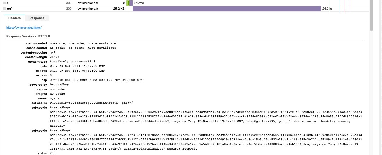

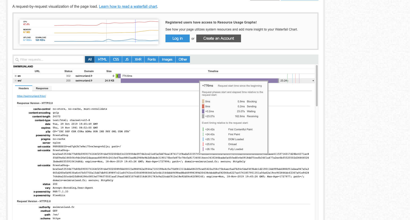

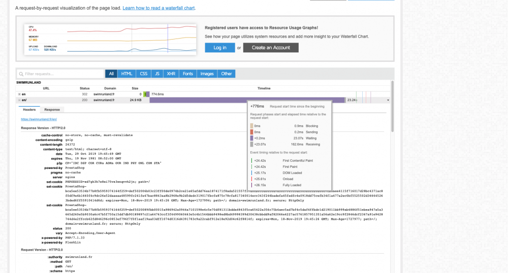

ghaitoute Posted October 29, 2019 Author Share Posted October 29, 2019 On 10/28/2019 at 4:48 PM, Alex said: This ExcludeDirectoryFileItterator.php tells pretty much actually. Wondering how much files he tries to iterate. But the problem seems to lie in symfony. I could be wrong though. But can you set the PHP version to 7.0 and try that? I know it is outdated. But just for a test-run. hello dear Alex, i tried set the php on 7.0 but the problem is always there, english version is so slow. can you please help me to understand the whaterfall char on the attached file i think it can help to understand the problem. Link to comment Share on other sites More sharing options...
ghaitoute Posted October 29, 2019 Author Share Posted October 29, 2019 On 10/28/2019 at 4:48 PM, Alex said: This ExcludeDirectoryFileItterator.php tells pretty much actually. Wondering how much files he tries to iterate. But the problem seems to lie in symfony. I could be wrong though. But can you set the PHP version to 7.0 and try that? I know it is outdated. But just for a test-run. hello Again dear Alex, finaly i understaind why the shop in english version is so slow! i added the english language manualy, i didn t import the pack language from prestashop, i just try it in new prestashop instalation and yes it s slow if you add the language manualy. to solve this i need to delete the english language from languages and import the english pack, the problem is if i delete the english language all the translation that i made will be delete it as well 😕 any idea how to delete the english language and keep the translations in the database? Thank you so much Link to comment Share on other sites More sharing options...
