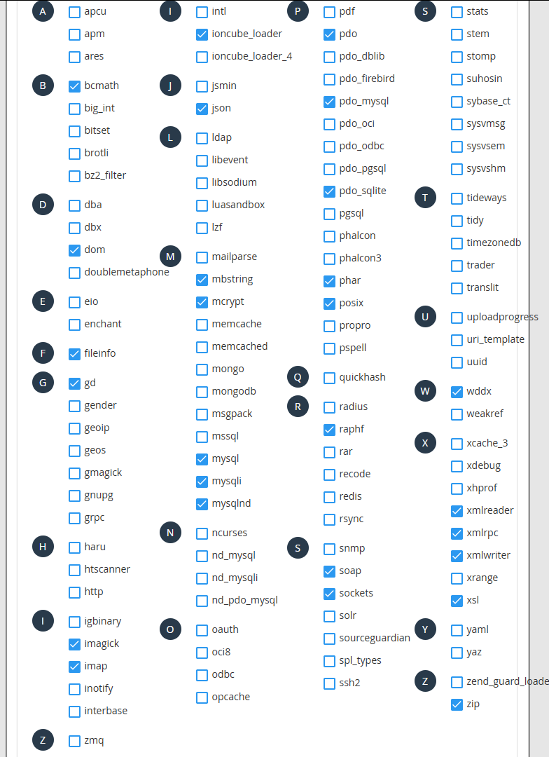

Hybrid_Halogen Posted October 17, 2019 Author Share Posted October 17, 2019 PHP Version on 5.6 with below extensions ticked. I suspect something is wrong here but can't seem to find the correct combination to work on any of the PHP versions Link to comment Share on other sites More sharing options...

Hybrid_Halogen Posted October 18, 2019 Author Share Posted October 18, 2019 on 7.2 I get so much more errors. sometimes frontend doesnt open, sometimes the orders and categories link in the backend give me error 500. after an entire day of trouble shooting from fresh installations, php 5.6 with above configs seems to work best Link to comment Share on other sites More sharing options...
