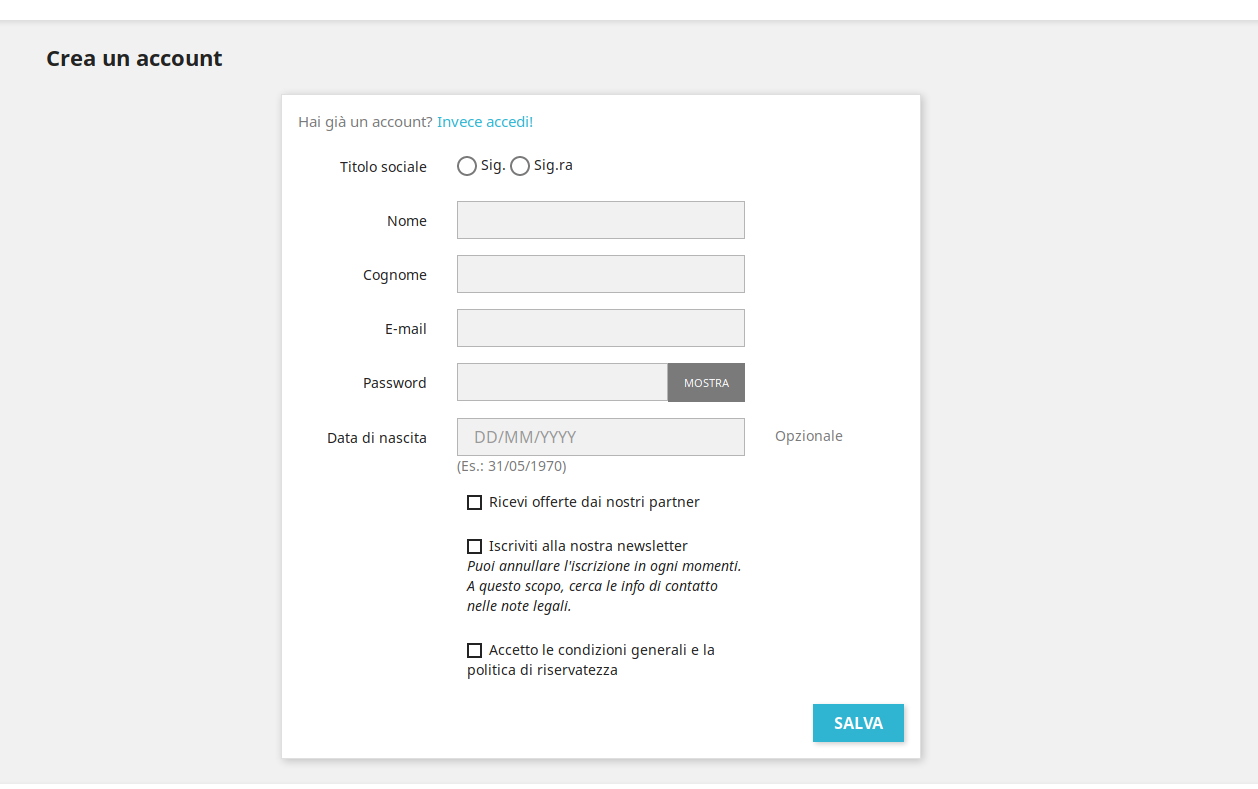

lemoeb Posted September 22, 2019 Share Posted September 22, 2019 (edited) I need to change the redirect after a customer has registered. In the form I am writing, I intercept the ActionCustomerAccountAdd Hook correctly and perform the operations necessary to my form. Without this, however, I would like to see my .tpl file and not the default prestashop file. I tried using Tools :: redirect but got nothing. Tips on how to do it? Thanks in advance My Code : Quote public function hookActionCustomerAccountAdd($param) { Tools::redirect('views/templates/front/confirm.tpl'); } P.S. After registering (since I disable the automatic client activation) I return to the registration screen itself (as in the figure), I would like to avoid this and make a riderect to a specific message of mine. Edited September 22, 2019 by lemoeb (see edit history) Link to comment Share on other sites More sharing options...
