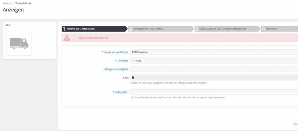

nanunana Posted September 19, 2019 Share Posted September 19, 2019 Hi, I try to add a new carrier in version 1.7.6.1 without success. I have double checked all settings, furthermore existing carriers and also database. Maybe here is someone who has the same issue and can help. Attached you will find a screen shot of the error Thank you so much best wishes Link to comment Share on other sites More sharing options...

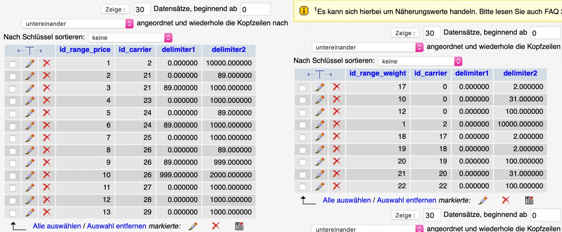

JBW Posted September 19, 2019 Share Posted September 19, 2019 Check the tables range_price and range_weight - there should be overlapping ranges that are not allowed. Link to comment Share on other sites More sharing options...
nanunana Posted September 19, 2019 Author Share Posted September 19, 2019 Hi, I see, but I cannot find the fault of this section. Maybe you can? Link to comment Share on other sites More sharing options...
JBW Posted September 19, 2019 Share Posted September 19, 2019 The weight table looks wierd, there is an ID 0 in there and these ranges do overlap. Link to comment Share on other sites More sharing options...
nanunana Posted September 19, 2019 Author Share Posted September 19, 2019 Hi, Yeah, that's it! Tanks allot and have a good day. Link to comment Share on other sites More sharing options...
