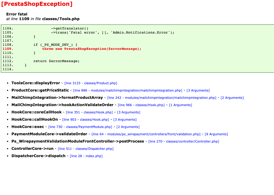

elxecommerce Posted September 12, 2019 Share Posted September 12, 2019 I've activated Bank transfer payment. When I click on complete payment a blank screen with just "Error fatal" appears. On debug mode appears the following problem (screenshot). PS: 1.7.5.1 Anyone could help? Thanks. Link to comment Share on other sites More sharing options...
JBW Posted September 13, 2019 Share Posted September 13, 2019 As you can see in the error messages this is caused by the Module mailchimp - try to deactivate the module. If this resolves the issue contact the module developer for support. 1 Link to comment Share on other sites More sharing options...
elxecommerce Posted September 13, 2019 Author Share Posted September 13, 2019 That was exactly the problem did not realise of MailchimpIntegration issue. Thanks a lot! Link to comment Share on other sites More sharing options...
