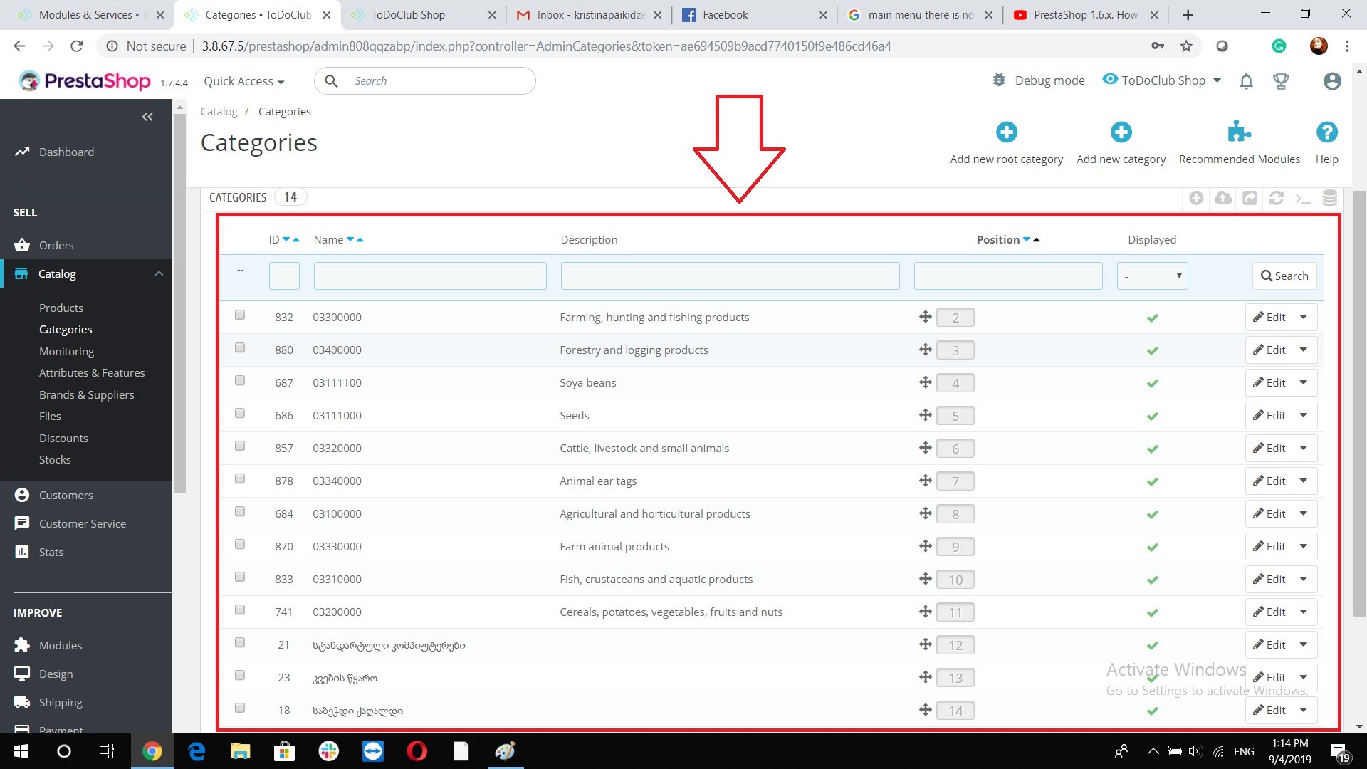

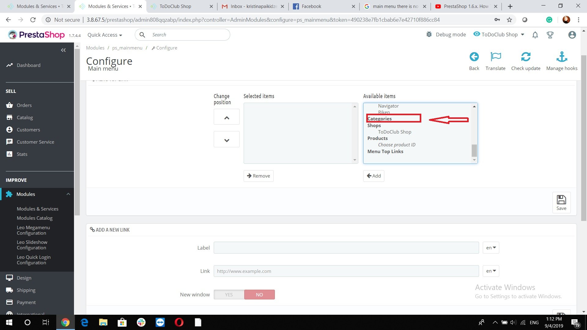

Kristianna Posted September 6, 2019 Share Posted September 6, 2019 (edited) Hello Guys! I am using Prestashop 1.7.6.1, recently we have imported categories an subcategories, now I want all categories to be shown in front-end and when I go to the module "Main Menue" there is no categories, even categories which were not imported but created manually. (please see screenshots attached bellow). Can anybody help with the issue! Thank you very much, for your help! Edited September 6, 2019 by Kristianna (see edit history) Link to comment Share on other sites More sharing options...
MichaelEZ Posted September 6, 2019 Share Posted September 6, 2019 To me it seems like problem with root dir, check your parental ID in DB Link to comment Share on other sites More sharing options...
Kristianna Posted September 6, 2019 Author Share Posted September 6, 2019 6 minutes ago, MichaelEZ said: To me it seems like problem with root dir, check your parental ID in DB "parental ID in DB" what is this? And how should I check it? Link to comment Share on other sites More sharing options...
MichaelEZ Posted September 6, 2019 Share Posted September 6, 2019 check table ps_category in database (phpmyadmin), u shoud be able to see your categories be id, so lets say parent id of category with id 832 is what number? Also chceck field is_root_category, those ids shoud be same, atleast in older PS ( im using 1.6, better say TB) Link to comment Share on other sites More sharing options...
