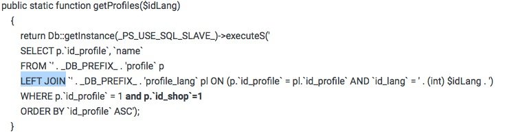

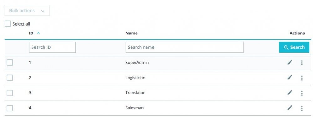

AleMac Posted August 30, 2019 Author Share Posted August 30, 2019 yes! this is (one of) original function on classes/Profile.php. the bold is what i want to add public static function getProfiles($idLang) { return Db::getInstance(_PS_USE_SQL_SLAVE_)->executeS(' SELECT p.`id_profile`, `name` FROM `' . _DB_PREFIX_ . 'profile` p LEFT JOIN `' . _DB_PREFIX_ . 'profile_lang` pl ON (p.`id_profile` = pl.`id_profile` AND `id_lang` = ' . (int) $idLang . ') WHERE p.`id_profile` = 1 and p.`id_shop`=1 ORDER BY `id_profile` ASC'); } but nothing changes at all! the final result is allways the same. the same 4 rows on profile (and profile_lang) tables (yes, i added an "id_shop" on profile table, and also put some value on that column) It's not cache… (i hope), it's not server's cache, browser's cache… what i'm doing wrong??? Link to comment Share on other sites More sharing options...

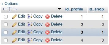

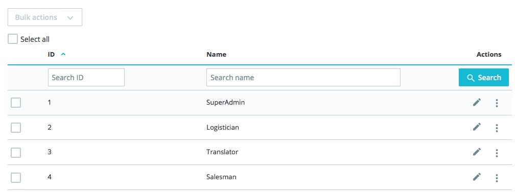

AleMac Posted August 30, 2019 Author Share Posted August 30, 2019 That's my actual table bellow. With the above query, i should see only 2 rows, but i'm still getting 4! It's like the system is cached or reading from another query location… Link to comment Share on other sites More sharing options...

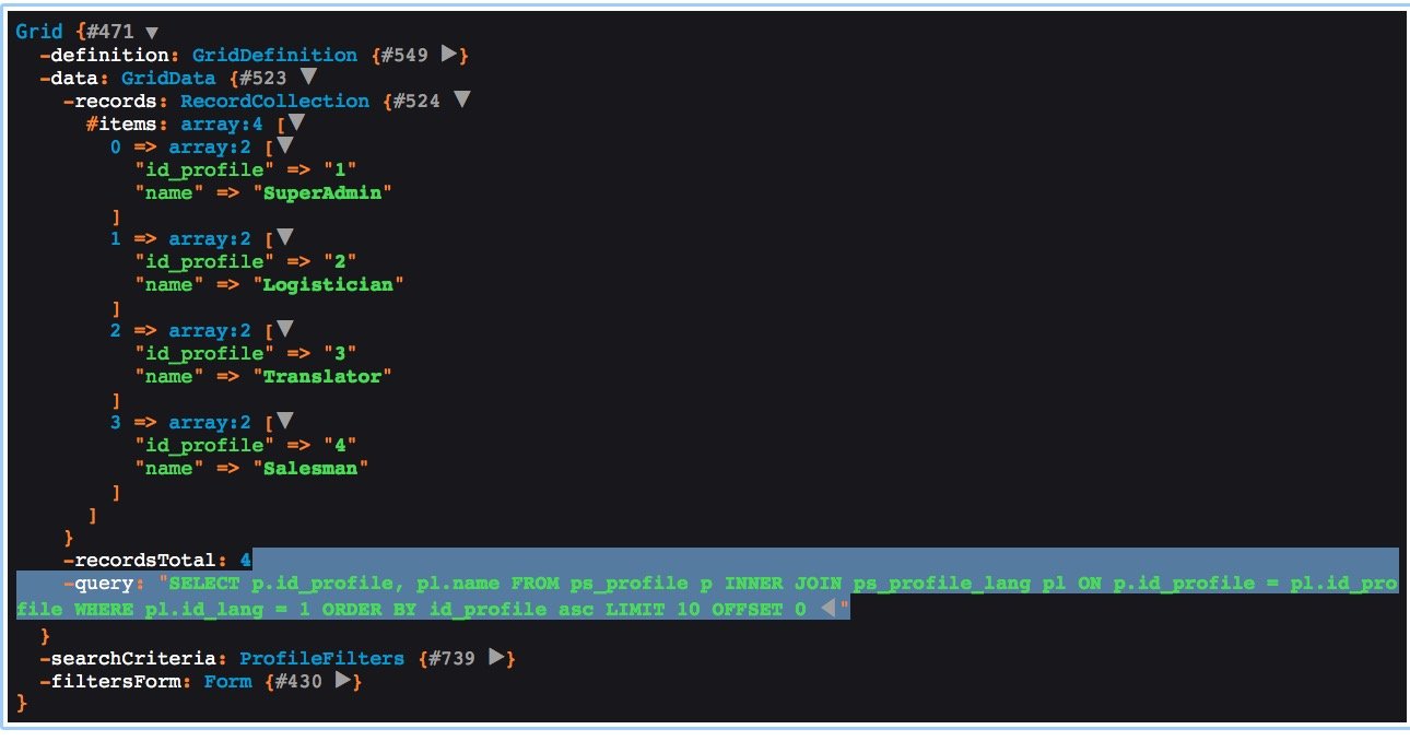

AleMac Posted August 30, 2019 Author Share Posted August 30, 2019 look at my code (for debugging) , the query, and the results. As you can see, the QUERY here, is different from the classes/Profile.php file. That's why i'm sure it's on a different file. On this file (/src/PrestaShopBundle/Controller/Admin/Configure/AdvancedParameters/ProfileController.php) it's INNER JOIN On classes/Profile.php file, is LEFT JOIN Anyone can help? Where is the query that return the values of …/index.php/configure/advanced/profiles? Link to comment Share on other sites More sharing options...
