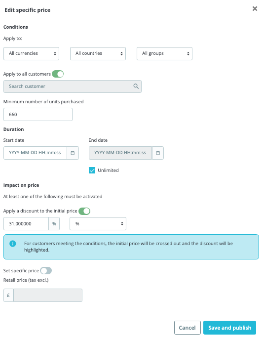

Hi, PrestaShop 8.1 How can I make the product specific price (discount by percentage) consistent throughout the shop and ordering process? Here my scenario and issue: Product base price: £0.30 Specific price by % discount: -31% from 1000pcs UK VAT @ 20% Rounding mode: Round on the total Currency decimal: 2 PrestaShop calculates the order as follows: The issue comes from the product price with discount applied which is: £0.207. £0.30 - £0.93 (31% discount) = £0.207 The shop's currency decimal is set to 2 and product discounted price is rounded to £0.21 but only on the display and invoice because the calculations are made from £0.207 which creates discrepancies. We cannot have £0.21 * 1000 = £207 Two acceptable options would be either: 1. Display product discounted price with all decimals (without turning the entire shop into this): £0.207 * 1000 = £207 or 2. Make the final calculations from the rounded product discounted price: £0.21 * 1000 = £210 I have explored all rounding options and sadly non provides an acceptable solution. Rounding on each item have the display of initial calculations correct: £0.21 * 1000 = £210 but in this option the tax is added to each item and rounded before the total is made which isn't desired: Price after discount excl. VAT: £0.207, rounded to £0.21 20% VAT applied to each item: £0.21 * 0.20 = 0.042, rounded to £0.04 Item price, incl. VAT: £0.21 + £0.04 = £0.25 Total for 1000pcs: £0.25 * 1000 = £250 Anyone have ideas on how to keep the product discounted price the same in the order display, invoice and in the calculations? Thanks

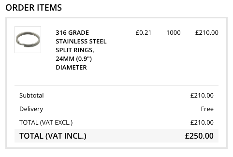

It appears that the PS calculations may be correct based on the following: Rounding mode: Round on each item Product base price: £0.30 Discount applied at 1000pc: -31% Price after discount excl. VAT: £0.207, rounded to £0.21 20% VAT applied to each item: £0.21 * 0.20 = 0.042, rounded to £0.04 Item price, incl. VAT: £0.21 + £0.04 = £0.25 Total for 1000pcs: £0.25 * 1000 = £250 In this example VAT is added to each item and then multiplied by quantities? Is there a way of changing this that first is a total calculated excl. VAT and then VAT is added? This would make the calculations more clear and avoiding rounding differences.

Hi, PrestaShop v8.1.7 Tested on fresh installation Settings: Product base price: £0.30 Specific price by discount: -31% from 1000pcs UK VAT @ 20% Rounding mode: Round on each item Rounding type: Round up away from zero, when it is half way there (recommended) Currency decimal: 2 Free delivery Quantity ordered: 1000 pcs PrestaShop calculations: Correct calculations should be: Subtotal: £210.00 Total (VAT excl.): £210.00 Total (tax incl.): £252.00 Regards, Jacek

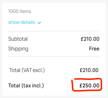

Hi, I am struggling with Tax calculation on PS 8.1.7 which I believe to be a bug. I have tested all rounding modes and rounding types. The problem for me appears with the Round on each item type, Round up away from zero, when it is half way there (recommended) mode for products that have Specific prices set by percentage. Here is my scenario: Currency decimal: 2 Round on each item Round up away from zero, when it is half way there (recommended) Specific prices set by percentage Product base price: £0.30 Discount at 1000pcs: -31% Tax: UK VAT @ 20% PrestaShop Order calculations: The calculated VAT (20%) from £210 should be £42 but PrestaShop calculated it as £40. I can't figure it out why and how to change it. The other 2 rounding types (Round on each line, Round on the total) have the tax calculations correct but the Item price with the discount applied is displayed wrong. It is displayed as £0.21 x 1000 = £207. For that reason I don't use these 2 rounding types: Any idea how to resolve the wrong tax calculations on Round on each item option or change the display of item price for Round on each line, Round on the total options? Regards, Jacek
