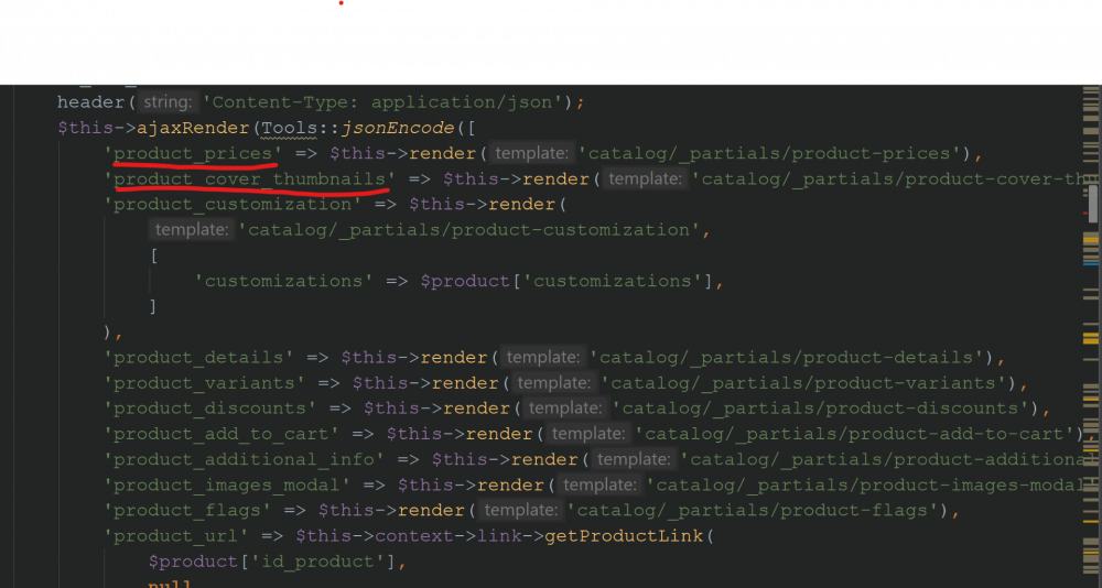

  22. Thank you Ress and Nickovitshj Indeed you are right, the variable {$product.embedded_attributes|json_encode} does not exist in my theme. the code below from the classic theme <div class="js-product-details tab-pane fade{if !$product.description} in active{/if}" id="product-details" data-product="{$product.embedded_attributes|json_encode}" role="tabpanel" > it is replaced by <div {if isset($SP_moreinfo) && $SP_moreinfo == 'tab'} class="tab-pane {if !$product.description} in active{/if}" {/if} id="product-details"> should I add the missing code below to my theme's product-details file ? data-product="{$product.embedded_attributes|json_encode}" role="tabpanel" Do you know in which file I can find the code for the second image ? Thanks again for your support
  23. Hello Ress Said and thank you for your very precise explanations, I have understood how the code works. You are right, unfortunately there is no data-product attribute in my HTML which contains the product details. My real need is to update the product description and name when the client changes the colour or size attribute. Currently with prestashop's native operation only the images and price refresh when you change the attribute. I can post the source code of my page if you want? My site is under maintenance but I use this theme: http://ps.ariestheme.com/themes/sp_autostore/fr/ Would you have another solution to solve my problem. Thanks again Said Translated with www.DeepL.com/Translator (free version)
