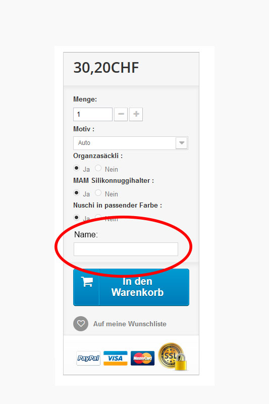

dszuecs Posted May 13, 2014 Share Posted May 13, 2014 Hi there I have a simple problem: Let's say i sell basecaps in my shop. Buyers should be able, to type in their name into a textfield, so i can print them a custom cap. I didn't find any solution to have a simple custom text field as product combination. I'd need a product combination called 'Name' type:'Text field', but this wasn't implemented in Prestashop I know, that i can add custom fields on a profuct itself, but to be honest, that looks ugly as hell and doesn't make sense.. Please check the attachement to see,what i'm trying to do. Thanks for any solution! Cheers Link to comment Share on other sites More sharing options...

vekia Posted May 15, 2014 Share Posted May 15, 2014 you can create only textbox go to product edit page and open "customization" tab add there "text field"t hen you can move it in product.tpl file above the cart buton. (now it's in footer section (by default)) Link to comment Share on other sites More sharing options...
dszuecs Posted June 3, 2014 Author Share Posted June 3, 2014 On 5/15/2014 at 1:27 PM, vekia said: you can create only textbox go to product edit page and open "customization" tab add there "text field"t hen you can move it in product.tpl file above the cart buton. (now it's in footer section (by default)) That doesn't work for me since the text i type in the field is not visible on the order Link to comment Share on other sites More sharing options...
vekia Posted June 3, 2014 Share Posted June 3, 2014 hello when you check products on products list, do you see customized text there? Link to comment Share on other sites More sharing options...
headscarvesbyciara Posted July 8, 2014 Share Posted July 8, 2014 Did you get a solution for this. I need the same thing almost: My requirement is: I have a size attribute ( currently set as radio because I think it looks better than a select box (the options are standard and custom measurement) If someone selects custom measurement (and only of they select it, so not appearing by default), Ideally I would like the customisation text box I have set in backend under product customisations) to appear just above the add to cart button on the product page . I don't mind if the user has to press a 'save' button before they add the newly customised product to their cart but it would be better from a usablity point of view if they did not have to make multiple clicks!! (I have read in other parts of the forum people have edited product.tpl and moved code to show product customisations text boxes above add to cart button) but wonder if someone could talk me through the whole process of making customisation text box only appear above add to cart button when someone selects the custom measurement radio button attribute? and making sure the contents of the customisation text box gets send with order I am using 1.6.0.6 and default bootstrap theme Thanks D Link to comment Share on other sites More sharing options...
