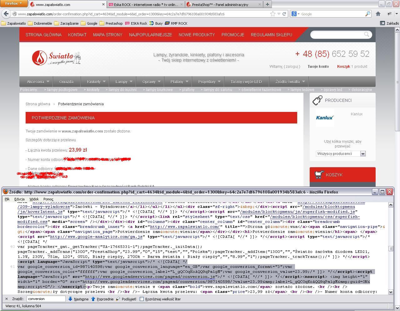

Hello
I'm trying add to my site google conversion code in (orderConfirmation) page. I have modified the file ganalytics.php. Below source code:

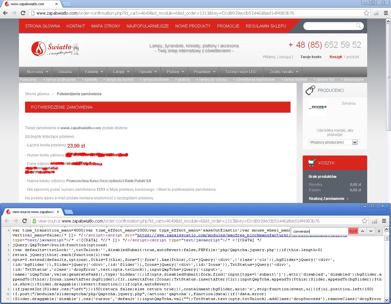

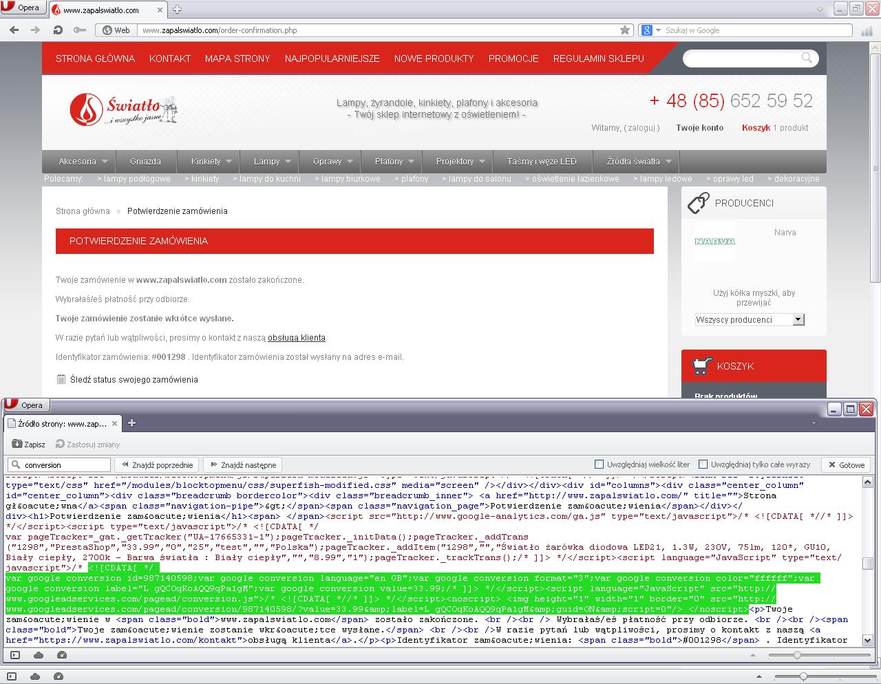

So, I have little problem with this conversion code. On browser like FireFox, Opera, Internet Explorer, this code is working fine. Screenshot in attachment.
But on Google Chrome this code is missing and i don't know why. I tried many ways to correct this code but still nothing.
Someone can help me with solve this problem. It's really important to me.
