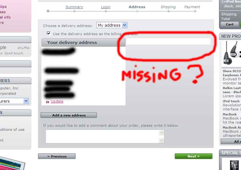

marjanbajc Posted June 15, 2011 Share Posted June 15, 2011 Hello everyone,I'm using PS 1.4.2.5TEST SITE: http://dev.bisoft.si/aa/in IE8 on one page checkout it doesn't display the invoice address.IE8 shows this error: Object doesn't support this property or method.Scrolled through the source and it seems it has problem with this line: var items = field_name.split(reg);Anyone know why is that?Thanks. Link to comment Share on other sites More sharing options...

a_smith Posted June 7, 2012 Share Posted June 7, 2012 On 6/15/2011 at 10:44 AM, marjanbajc said: Hello everyone, I'm using PS 1.4.2.5 TEST SITE: http://dev.bisoft.si/aa/ in IE8 on one page checkout it doesn't display the invoice address. IE8 shows this error: Object doesn't support this property or method. Scrolled through the source and it seems it has problem with this line: var items = field_name.split(reg); Anyone know why is that? Thanks. Hi all I am having very similar issue. But in my case all of the payment methods doesn't appear at the bottom of OPC/cart. My shop does it only in IE8. No problem with other browsers. IE in-biuld error console says: Object doesn't support this property or method, order, line 33, character 33 Line 33 with the code highlighted is: {var reg=new RegExp("[ ]+","g");var items=field_name.split(reg);var vals=new Array();for(var field_item in items) I've found the code. This line comes from the theme order-address.tpl file. In the other case it was jQuery textshadow script conflicting. My problem is that I dont use this script and I can't find what's wrong. Any help and/or ideas please? Link to comment Share on other sites More sharing options...
